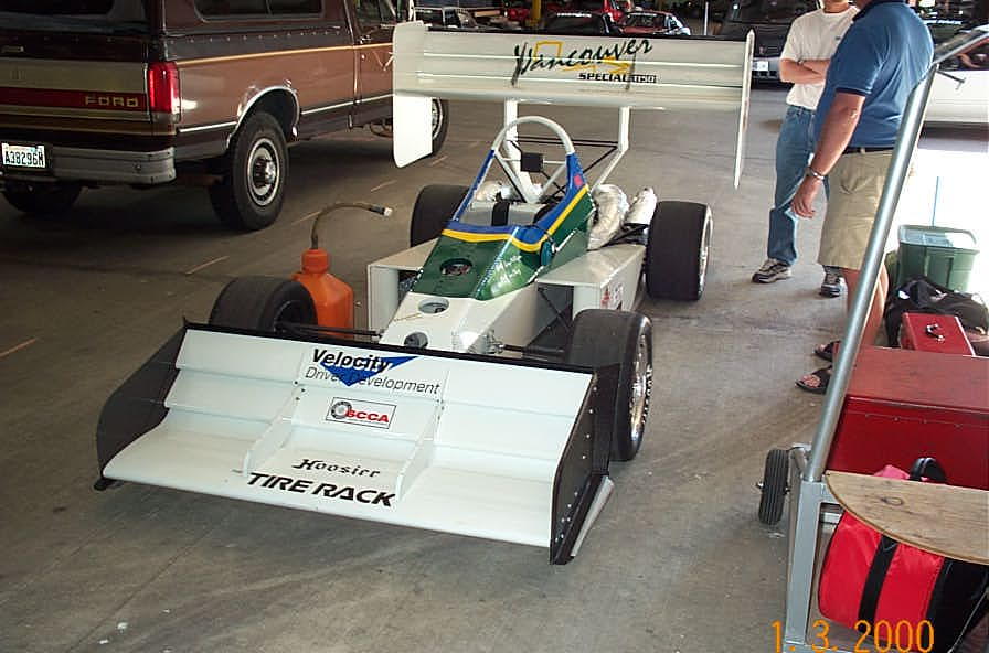

It really won't make any difference in an autocross situation Jon. Only on the track do these ground effects really work wonders. On the track a splitter also needs to be balanced by a spoiler.

Humph.......tell it to this guy.

jd74914   Ok, they will make a difference, if they're bi...   Feb 7 2008, 08:10 PM

J P Stein   IF I could come up with a 200 sq in wing at a reso...   Feb 7 2008, 08:22 PM
