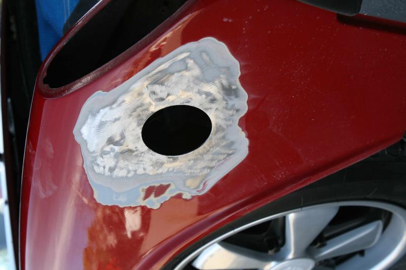

So I've decided to confront a few rust bubbles on my car, before painting it (the car looked great, but I never liked the wavy sides due to poor prep and no blocking).
If you can't stomach this first photo, please don't continue... (IMG:style_emoticons/default/biggrin.gif)

And then there's a right way to do it... (IMG:style_emoticons/default/welder.gif)
