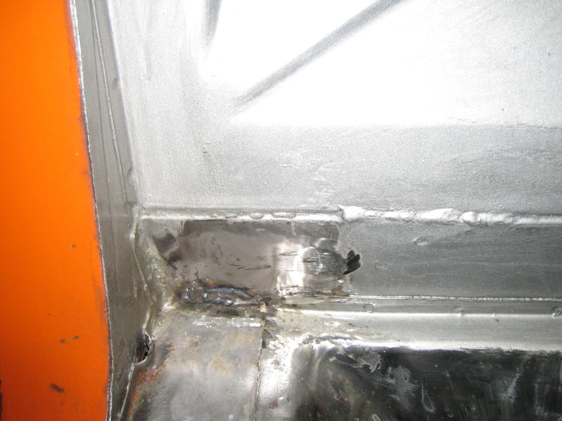

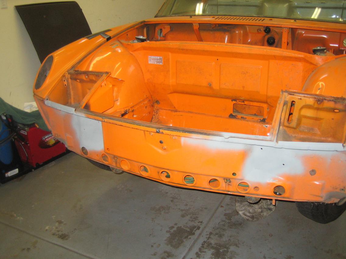

So bumper shock holes are now done, last one went sooo much better than the 1st one (IMG:style_emoticons/default/smile.gif)
Also patched some thin metal on the inside, could not get the grinder to the weld at the bottom.
