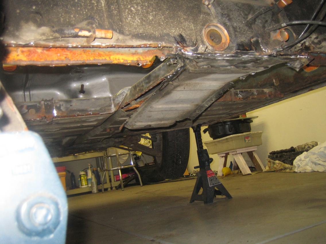

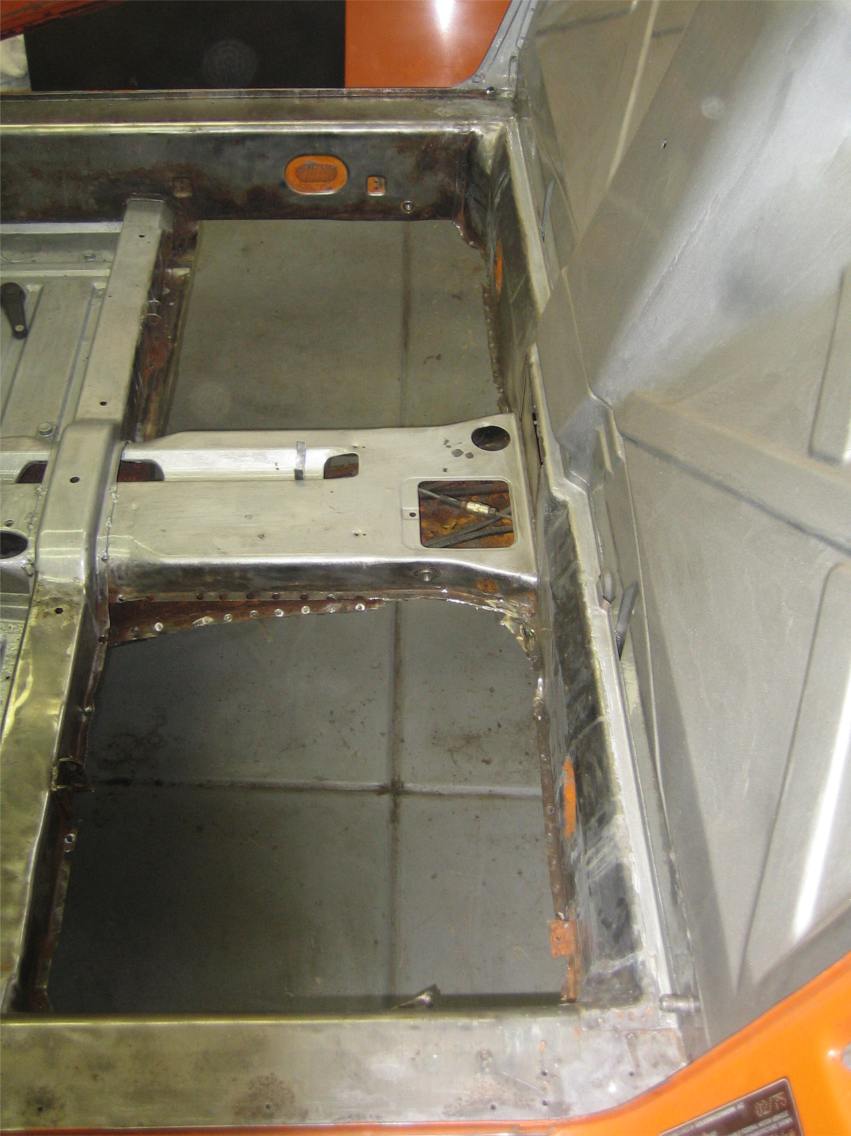

OK now onto the BIG job of the day, the floor pan removal. Wonder how much you would have to pay to have someone do this? A lot me thinks.
I ran out of steam so I cut out the big pieces and left the center section for another day, someone has seam welded the rear center and at that point I decided to call it quits till tomorrow.
New floor pan arrived Friday but there is plenty of clean up before that goes in.

my928s4   So while making progress with the grinder and wire...   Jan 13 2008, 05:51 PM
my928s4   And then a 2nd coat, looked pretty good so I will ...   Jan 13 2008, 05:55 PM
my928s4   OK, couple of questions. What should I do with th...   Jan 13 2008, 05:59 PM

my928s4   Two new rear jack points were welded in. Here y...   Oct 26 2008, 11:09 AM
