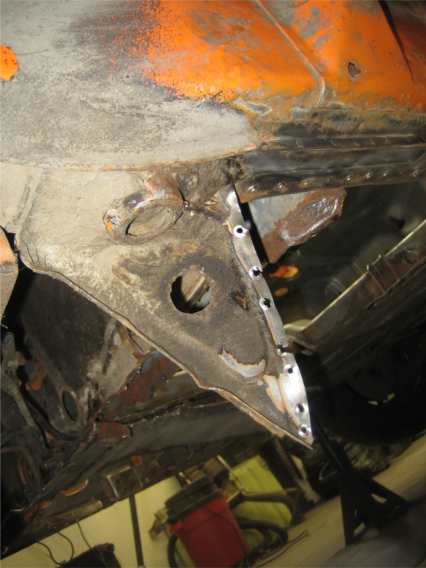

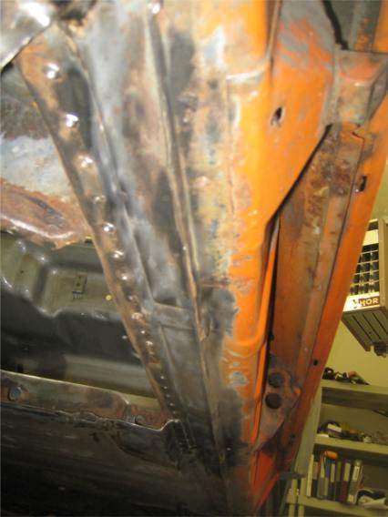

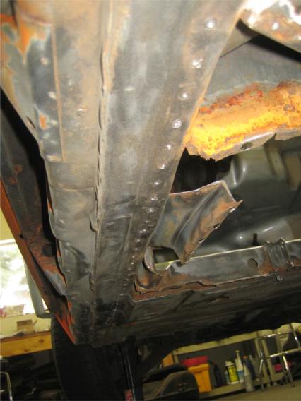

Got the wire wheel attachment on the grinder and decided to check out the state of the surfaces this morning, longs look great and most of the rust is superficial so that is good.
Decided I might as well clean up the underside and most of the undercoating and paint came of pretty easy, thinking another 3-4 messy hours and it will be done.
Here are the longs.

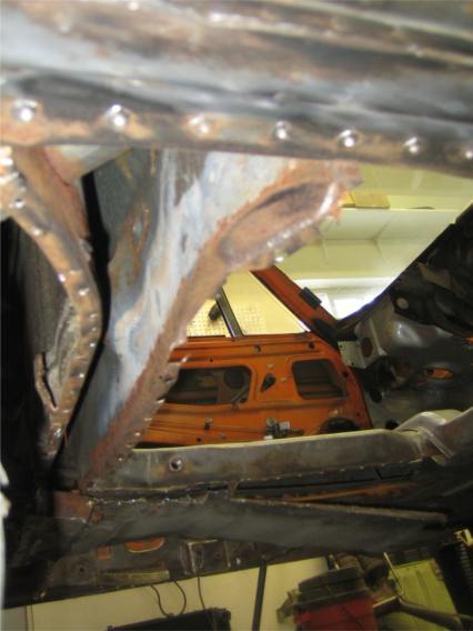

One thing about replacing the rear floor pan is the jack posts cover the rear corners, I could have removed them and re-used but new ones would be better.
Here is a shot looking into the rear bulkhead.
