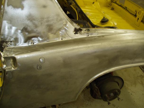

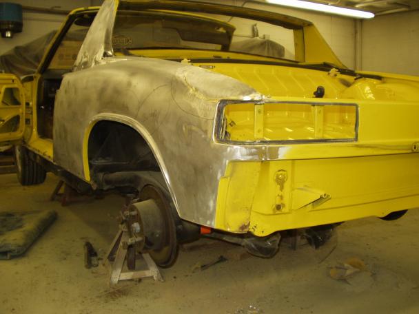

So I've decided to confront a few rust bubbles on my car, before painting it (the car looked great, but I never liked the wavy sides due to poor prep and no blocking).
If you can't stomach this first photo, please don't continue... (IMG:style_emoticons/default/biggrin.gif)

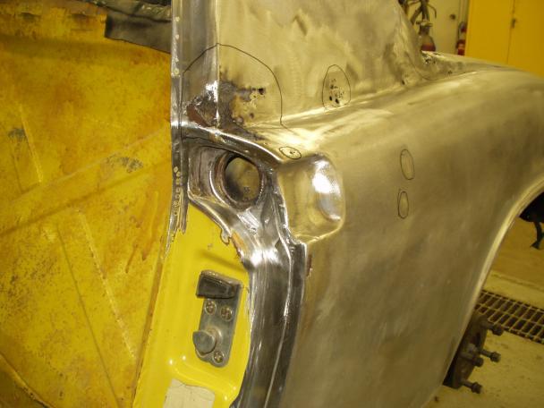

Pete,
Make sure that your shop does a thorough search for rust. I thought my '70/4 was pretty nice, but the ravages of time, salty winter roads and latent moisture ultimately caused more damage than was readily apparent.

Hey Paul,
I saw your pics a while back and they inspired me to get going sooner than later. (IMG:style_emoticons/default/blink.gif) And now they've inspired me to pull my aluminum threshold plates. I was relieved, however, to find no rust evident on the longs, at the bottom of the firewall on the passenger side. I'm an Optima battery customer since 1991, and one who is happier than ever to have made the switch...
Your pics also serve as a good cautionary tale for rust in general... Let me ask you this: Was the rust on the back of the sail panel evident when you stripped the vinyl away? What about elsewhere? Did you have a couple bubbles here and there and decided to fix them? Or did you strip to metal and only then find the issues?

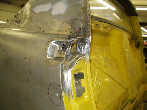

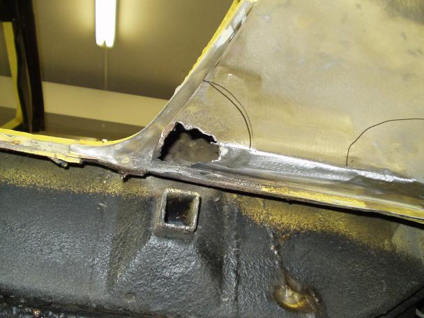

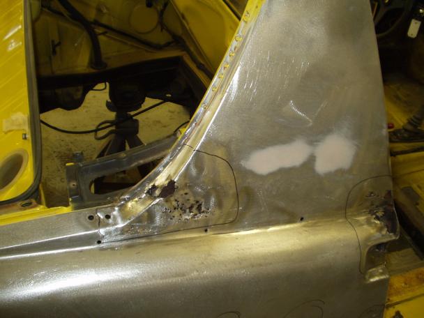

Pete,
Although the vinyl sail panel had no blistering or lifting/loosening of material and seemed to be solid, once it was removed, it was apparent the extent of the rust damage far exceed the 3 or 4 very small paint blisters that had appeared in almost the exact same place as shown in your photo on post #5 of this thread. I'd decided to address the rust issues on the pan of the car, never imagining the extent of the metal degradation on many parts of the exterior sheetmetal.
Here presented (again) were some surprising rust issues that were uncovered when the paint was removed.

horizontally-opposed   So some progress has been made... First up are be...   Mar 6 2008, 12:09 AM
horizontally-opposed   Next up... the targa bar and LR fender by the tail...   Mar 6 2008, 12:11 AM
horizontally-opposed   Here's where things get interesting. After sc...   Mar 6 2008, 12:20 AM
horizontally-opposed   The two pinholes in the right front fender filled....   Mar 6 2008, 12:21 AM
horizontally-opposed   BUT, here's where the bummers begin. Same are...   Mar 6 2008, 12:24 AM

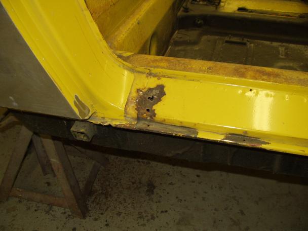

horizontally-opposed   Get up close to things, and you can see where the ...   Mar 6 2008, 12:49 AM
horizontally-opposed   The right side beam under the seat, which appears ...   Mar 6 2008, 12:52 AM
horizontally-opposed   Unfortunately, here's where I got more than a ...   Mar 6 2008, 01:02 AM
