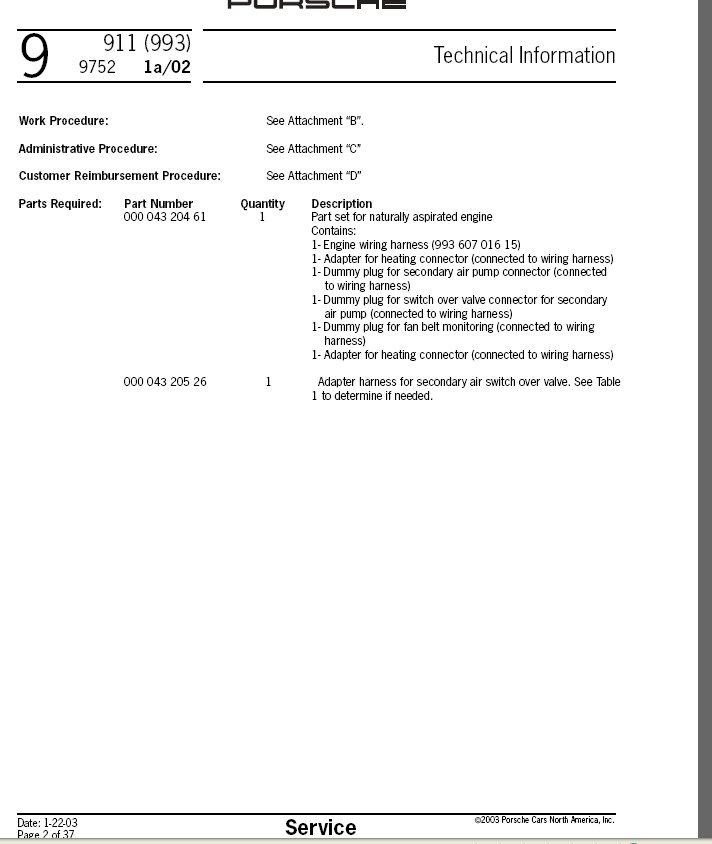

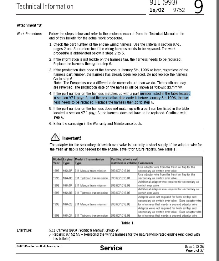

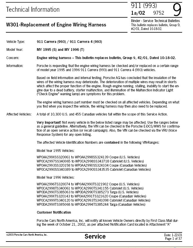

Here is a little more info. There was a recall on the engine harness for 95-96. The dealers had harneses (normally about $800.00) for $115.00 to be billed out for the recall cars. Must have been a bean counter deal. Andy, good job on the score. The recall harness is identical to a harness you would buy except the part # on the box should start with 000. Inside the box is the same harness though with the right part #....go figure
Here is the bulletin info. Those that have 3.6 engines can back-track the engine # to get the VIN number and ultimately see if your engine is suspect.
