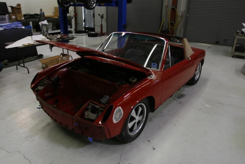

So I've decided to confront a few rust bubbles on my car, before painting it (the car looked great, but I never liked the wavy sides due to poor prep and no blocking).
If you can't stomach this first photo, please don't continue... (IMG:style_emoticons/default/biggrin.gif) pete Attached thumbnail(s) |

horizontally-opposed Kit in place... Apr 7 2008, 01:55 PM
horizontally-opposed closer... Apr 7 2008, 01:58 PM
horizontally-opposed Bulk of sills are still Bahia thanks to the alumin... Apr 7 2008, 01:59 PM
horizontally-opposed Once the jack-post boxes were cut away, we found s... Apr 7 2008, 02:02 PM
horizontally-opposed and the left side... Apr 7 2008, 02:02 PM
horizontally-opposed So this is where the car stands today. Just a litt... Apr 7 2008, 02:05 PM
horizontally-opposed And from the rear. Man those 165s on steelies are ... Apr 7 2008, 02:06 PM
