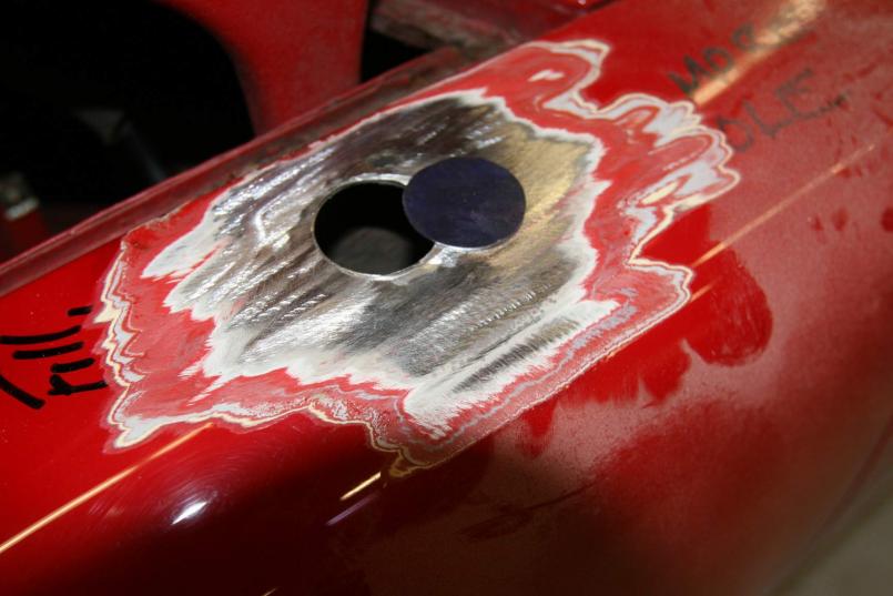

Posts: 3,456
Joined: 12-May 04
From: San Francisco
Member No.: 2,058
and, while we're at it, antenna be gone...

horizontally-opposed   and, while we're at it, antenna be gone...   Feb 13 2008, 09:02 PM
