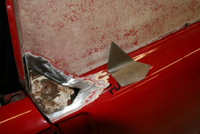

but by far the worst damage is this.... I wish I'd got after this sooner (first spotted it festering in the 1990s) but I am glad I didn't let it go much longer...

horizontally-opposed   but by far the worst damage is this.... I wish I...   Feb 13 2008, 09:04 PM
horizontally-opposed   After melting the factory gunk (it is TOUGH stuff,...   Feb 13 2008, 09:05 PM
