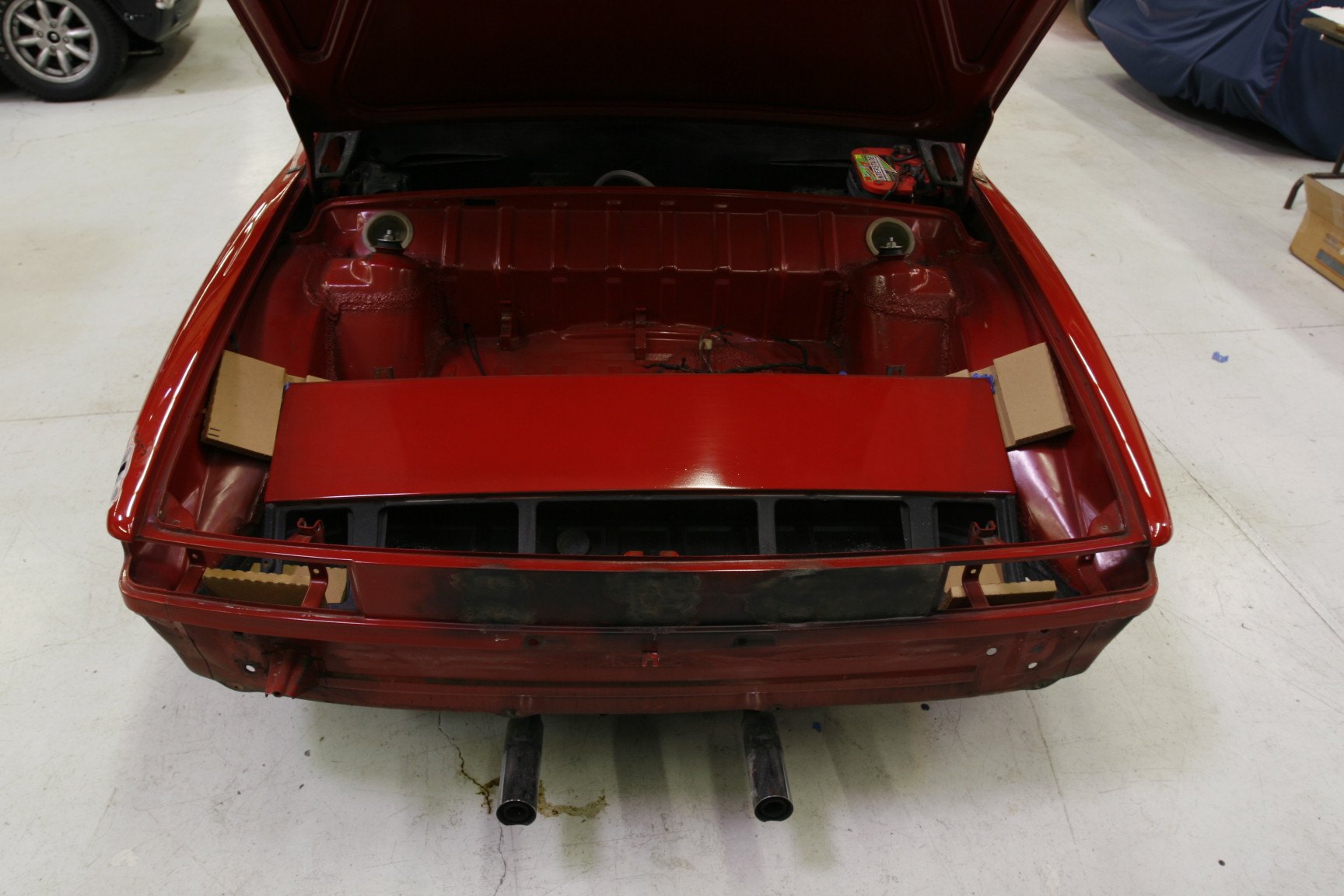

horizontally-opposed
post Feb 13 2008, 09:10 PM
Posts: 3,456
Joined: 12-May 04
From: San Francisco
Member No.: 2,058
engine lid in trunk, ready to go to paint shop...
given what I've seen on a lot of 914s, I went into this gig pretty scared. So far, it's not so bad. Longitudinals seem to be VERY solid, the firewall is good, and we're not finding indications of rust anywhere else. But I'll be going over the car VERY carefully before sending it to paint.
For now, that's all. Front trunk seal gutter is pretty good, with just two TINY holes at the top corners. I think I'll kill the rust, prep them, and then make sure to seal them off well with the new trunk seal.
Re-sealing the areas where repairs have been done are scaring me a bit, however....
pete
