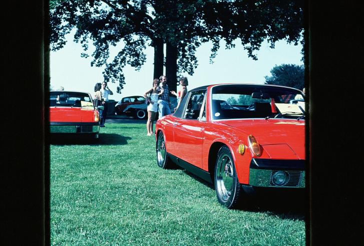

a pair wearing Bahia Red......

Travis Neff   Keep that Toranado red - it looks great on your ca...   Feb 14 2008, 12:43 PM
1970 Neun vierzehn   a pair wearing Bahia Red......   Feb 14 2008, 01:22 PM
horizontally-opposed   Thanks very much for posting that!!! I...   Feb 14 2008, 02:17 PM
Ferg   I've owned both colors :D these shots were ...   Feb 14 2008, 02:57 PM
watsonrx13   Another sample of Bahia Red... I had this car pain...   Feb 15 2008, 07:49 AM
