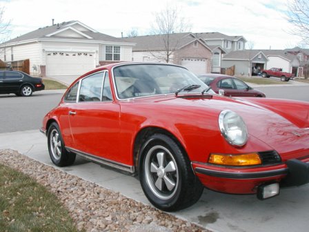

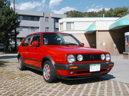

I've owned both colors (IMG:style_emoticons/default/biggrin.gif) these shots were taken with the same camera, but different years... Both cars were orig paint, 911 "mostly" original/
My Bahia 73.5 T
And my Toronado Red GTI
Pete, PM me you email, and I'll send you both gallery's of each car.
Ferg (IMG:style_emoticons/default/beerchug.gif)
