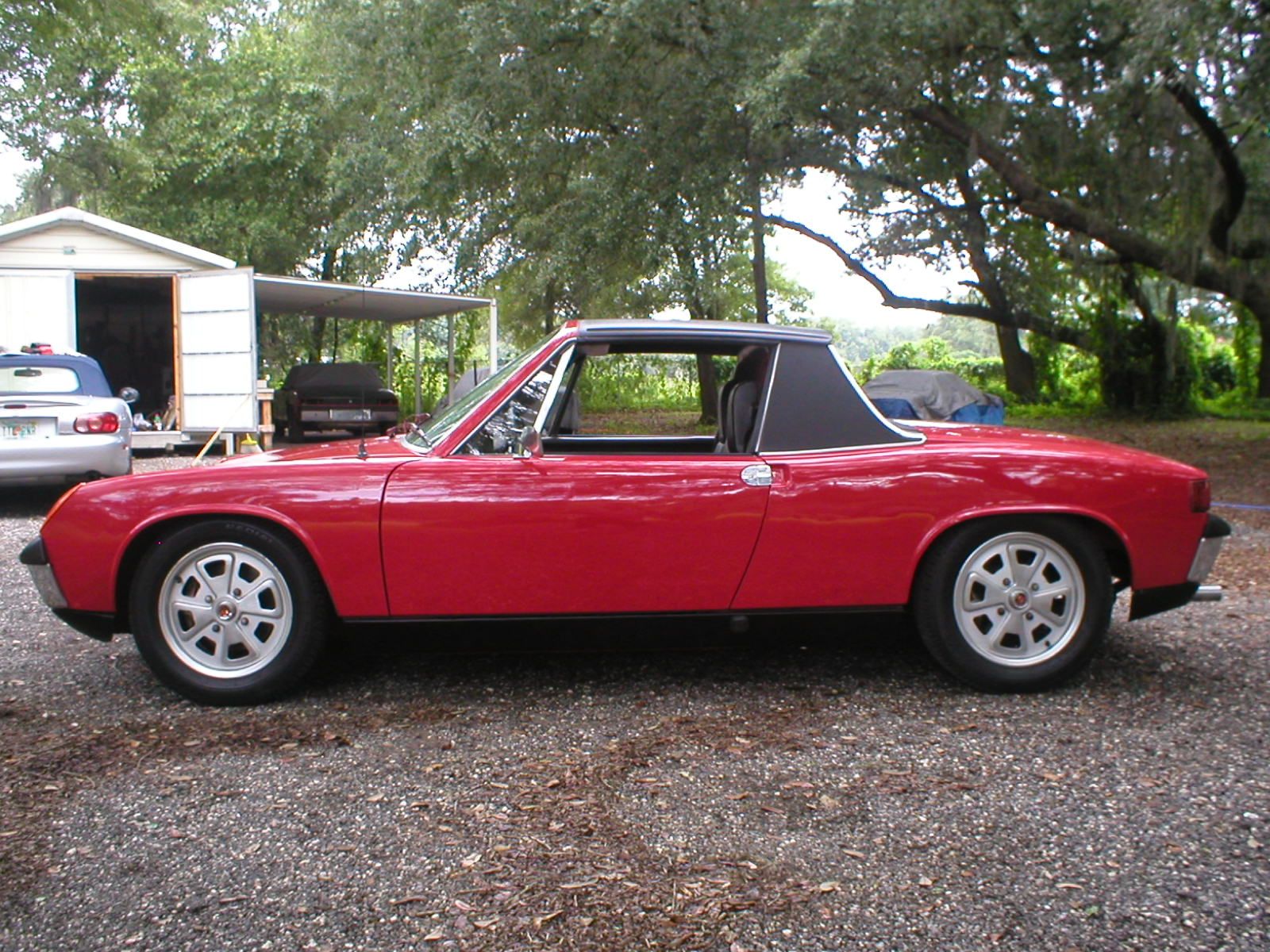

Another sample of Bahia Red... I had this car painted at a local paint shop last year, using DuPont single stage acrylic-enamel... so my recommendation is original paint.
(IMG:http://www.914world.com/bbs2/uploads_offsite/www.tampabay914.com-312-1291033014.1.jpg)
-- Rob

watsonrx13   BTW Pete, if you didn't already know, the firs...   Feb 8 2008, 05:51 PM

Porsche Rescue   I too am a bit of a back to original purist. But s...   Feb 14 2008, 11:23 AM
Travis Neff   Keep that Toranado red - it looks great on your ca...   Feb 14 2008, 12:43 PM
1970 Neun vierzehn   a pair wearing Bahia Red......   Feb 14 2008, 01:22 PM
horizontally-opposed   Thanks very much for posting that!!! I...   Feb 14 2008, 02:17 PM
Ferg   I've owned both colors :D these shots were ...   Feb 14 2008, 02:57 PM
watsonrx13   Another sample of Bahia Red... I had this car pain...   Feb 15 2008, 07:49 AM
