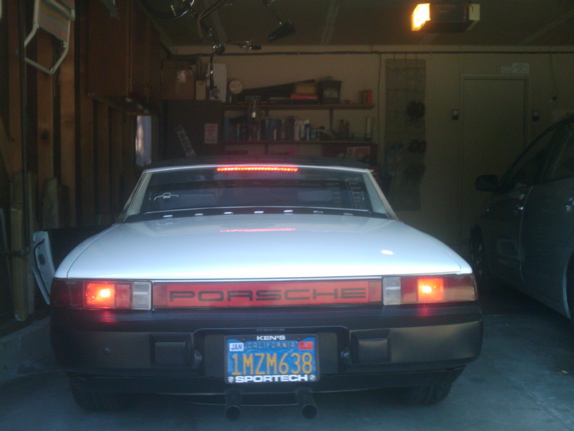

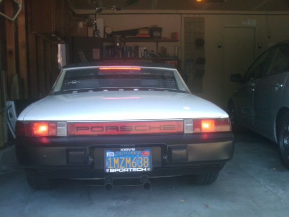

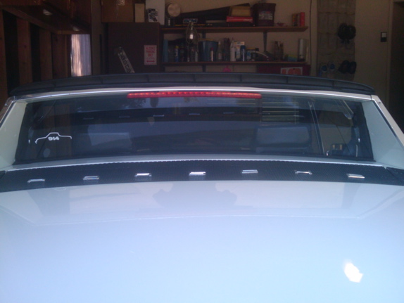

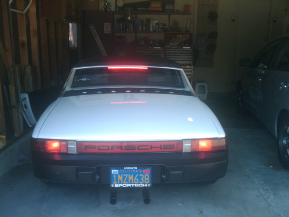

got a 3rd brake light bar from a 993. The curvature is almost exactly that of the underside of the targa bar. Ran the wires thru the trim down the left side and back to the left tail light for ground and brake light signal.
not too bad for about an hour... (IMG:style_emoticons/default/biggrin.gif)

DanT   pics really won't show you anything for the mo...   Aug 12 2010, 08:50 PM

DanT   well Tom, that is just about as high as I can get ...   Aug 12 2010, 09:32 PM
DanT   wow, just went out and tried it in the dark......t...   Aug 12 2010, 10:13 PM
