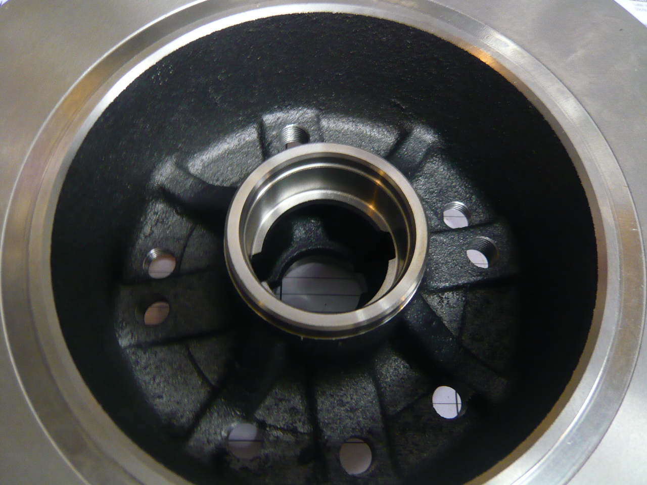

First, looking at the backside you can see none of the webs have to be cut out or removed. In order to press in a Verbus stud a major amount of the webbing on two webs had to be removed. Not here:

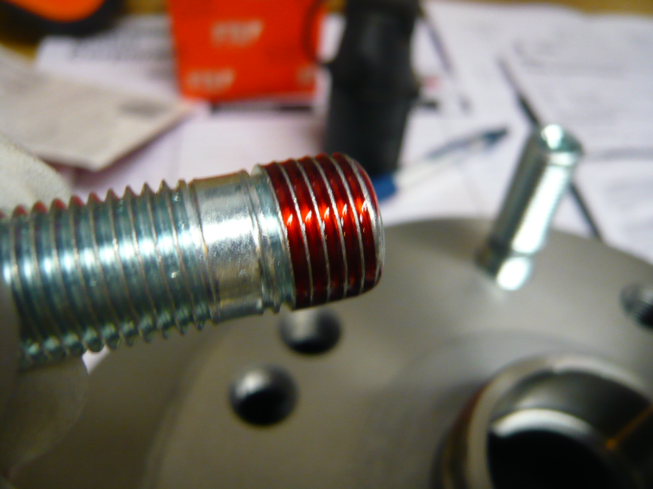

The key to doing this right is to use the "Red Stuff":
Here's the application on the threads:

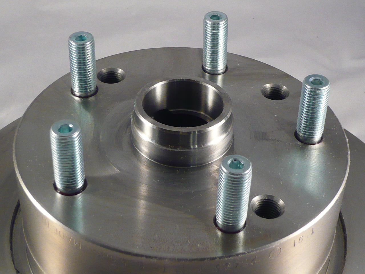

Finished product:
Bottom line: 5x130 pattern with a 14x1.5 tap, 10 14/14x1.5 studs, Red locking compound and away you go. These are also late rotors that have had the centering ring milled off to accomodate the Fuchs. Yeah they're not Verbus but in this configuration I'll guarantee them against the life of the rotor (and then some). What I mean by and then some is, if you go through a rotor you can simply heat these with a MAP torch and remove them and use them on the new setup.
Again, if you're intent on using 914 rotors, I think this is not only the best way to do this (more meat on the back of the rotor and very clean install) but, quite accessable for the home mechanic. You just need to pay the machine shop. (IMG:style_emoticons/default/wink.gif)
