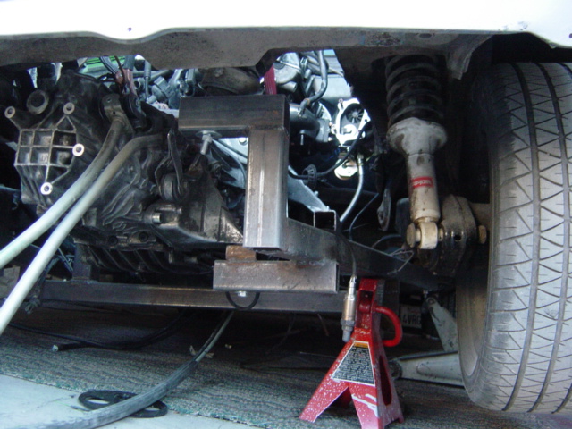

I've enjoyed seeing pics of everyones cars and buildups. Few people wanted me to post some pics of the work in progress and I finally found my digital camera, so here are a few pics:
914_1.8t   Project 914 1.8T   Sep 25 2004, 07:14 PM
914_1.8t   Above was a pic from the back showing the sub-fram...   Sep 25 2004, 07:16 PM
914_1.8t   Pic of ground/engine clearance from under car:   Sep 25 2004, 07:17 PM
914_1.8t   Pic from below of turbo almost hitting battery tra...   Sep 25 2004, 07:18 PM
914_1.8t   Seat that I will be using (from late model RX7) an...   Sep 25 2004, 07:19 PM
914_1.8t   I pushed the fender out sightly (about 2"), when t...   Sep 25 2004, 07:22 PM
914_1.8t   So, i've managed to get the motor started but ...   Sep 25 2004, 07:26 PM
Hi_Fi_Guy   Very cool project. Besides all the obvius stuff we...   Sep 25 2004, 07:55 PM
bob91403   Seat looks good. Does it give enough room for the ...   Sep 25 2004, 08:10 PM
scott thacher   quik ? which tranny are you using and how do you...   Sep 26 2004, 01:44 AM

914_1.8t   Update... Before I could get the enfine to fire u...   Oct 6 2004, 07:03 PM
914_1.8t   Radiator with some misc radiator hoses I found at ...   Oct 6 2004, 07:07 PM
914_1.8t   Pic of the car: Still need to work on those 1/4 pa...   Oct 6 2004, 07:08 PM
914_1.8t   oops...lets try again: I think i will need adjusta...   Oct 6 2004, 07:10 PM
914_1.8t   One more from the side... Paint looks pretty crapp...   Oct 6 2004, 07:12 PM
