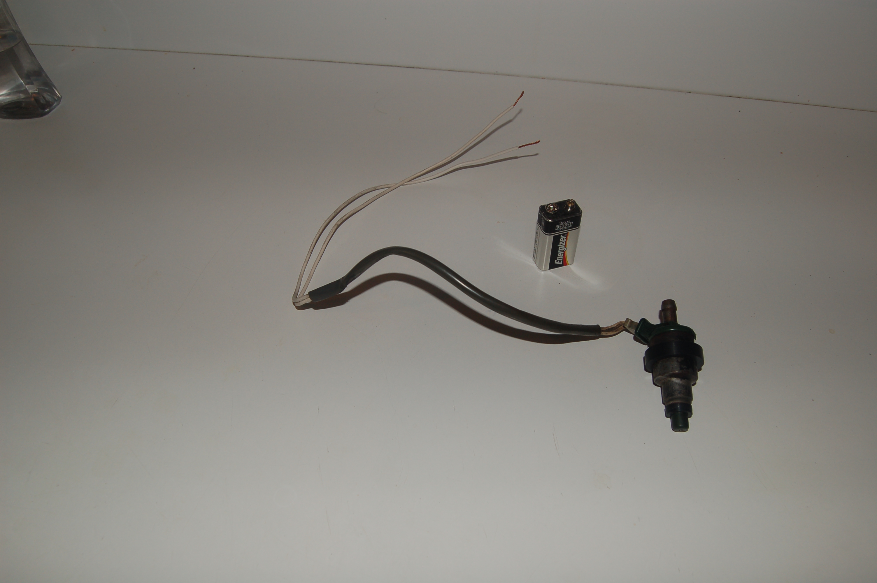

OK,
I hooked up a pig-tail to this injector. Then I got a 9V battery and tapped the pig-tail numerous times.
I never hear the injector click - and I'm assuming that it should.
The pig-tail does spark though - as if there is a short - which seems odd.
So, what is that telling me?
BTW - PO has said that all the injectors were cleaned and tested and all tested and sprayed well. They were however sitting in a baggy for three months. I can't imagine that they just went south????
All four injectors and the cold start valve all behave the same way.
Thanks,
Len
