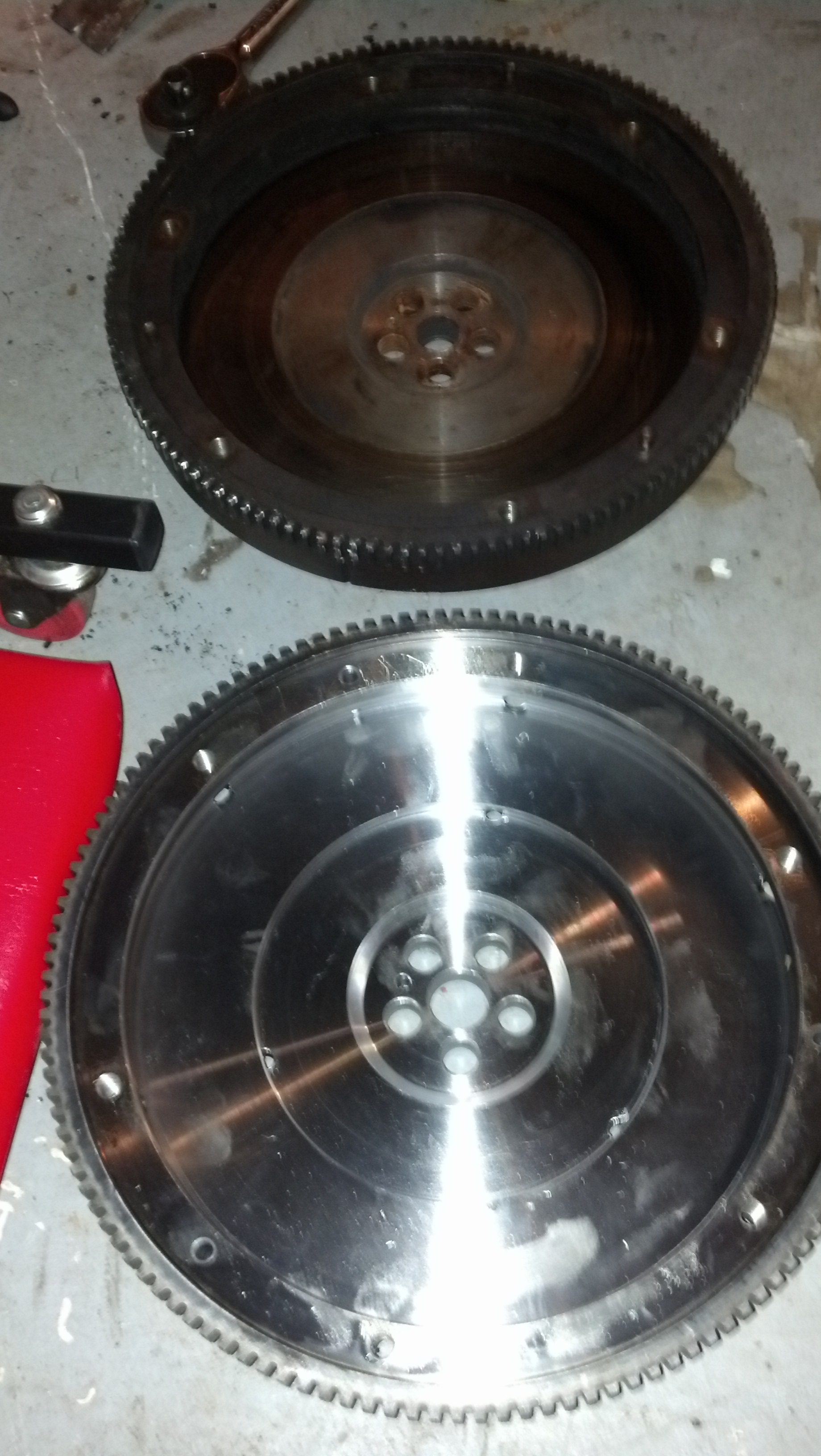

**new question, the mark on the flywheel was in the down position when removed, so i marked the new one same location upon installation- so for doing valves and timing, what position is this in now, 180 off of the #1TDC?
New flywheel is not marked for Tdc and it does not have the dowels/pins to align and mount the clutch to. Can I mount it with out these.? Attached thumbnail(s) |

Dave_Darling You need the dowels. They take the rotational str... Jan 11 2014, 11:12 PM
Mark Henry Another thing I have noticed on the new flywheel b... Jan 11 2014, 11:40 PM
Philip W.
Another thing I have noticed on the new flywheel ... Jan 12 2014, 06:25 AM
Cap'n Krusty The dowel pins knock out from the back. Use a goo... Jan 12 2014, 12:34 AM
dangrouche you should get a flat punch and be able to drive t... Jan 12 2014, 12:34 AM
