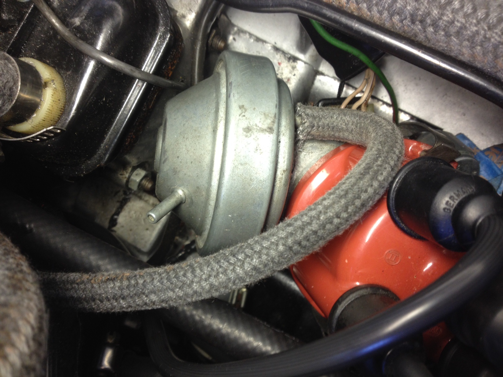

Ok 73 2.0 built to a 2056. Currently running points. Checked dwell and set to specs. I was setting the timing and I have a timing light that you can set in the advance.
1st question: Can you use the advance setting on the timing light instead of the 27 at 3500 rpm?
2nd question: My dizzy has 2 vacuum ports. One is advance and one is retard. My throttel body only has one vacumm port for the dizzy. Do I need both hooked up?
3rd Question: Do I have the vacuum line on the correct (advance) side?
4th Question: when I check the timing (just for fun) with the vacuum hose hooked up as shown the timing is not anywhere close to 27 at any rpm. That seems odd.

Java2570   1) yes 2) if you only have the one throttle body p...   May 12 2014, 04:17 PM
stugray   yes. Push the rear tin back over the engine cas...   May 12 2014, 04:20 PM
The Cabinetmaker   Remove the vacuum line and plug it when timing   May 12 2014, 05:17 PM
914_teener   Yea...I was gonna say that....also, but I'm no...   May 12 2014, 05:22 PM
Mblizzard   I think I will try the advance light method as I h...   May 12 2014, 07:31 PM
r_towle   Looks to me like you have the vacuum line hooked u...   May 12 2014, 09:13 PM
Bleyseng   That is the vacuum retard that the hose is hooked ...   May 13 2014, 05:11 AM
Mblizzard   So we have a couple of differing opinions on the c...   May 13 2014, 05:58 AM
r_towle   So we have a couple of differing opinions on the ...   May 13 2014, 07:23 AM
Mblizzard   So we have a couple of differing opinions on the...   May 13 2014, 07:39 AM
type47   Anyone have a definitive answer as to which side ...   May 13 2014, 07:29 AM
Java2570   Bleyseng is correct and every hose diagram I'v...   May 13 2014, 06:58 AM
r_towle   Oh, put a hose on each port, one at a time and suc...   May 13 2014, 07:25 AM
r_towle   Remove the hose and cap it so you don't have a...   May 13 2014, 07:44 AM
Java2570   http://www.914world.com/bbs2/index.php?showtopic=1...   May 13 2014, 07:45 AM
Mblizzard   Ok so I removed the hose from the regard side and ...   May 13 2014, 08:45 AM
Cap'n Krusty   Time for me to check in. The diameter of the reta...   May 13 2014, 09:16 AM
r_towle   Time for me to check in. The diameter of the ret...   May 13 2014, 06:42 PM
Cap'n Krusty   Time for me to check in. The diameter of the re...   May 13 2014, 07:44 PM
barefoot   OK, i have a ditzzy with both vacuum ports and am ...   May 13 2014, 11:43 AM
