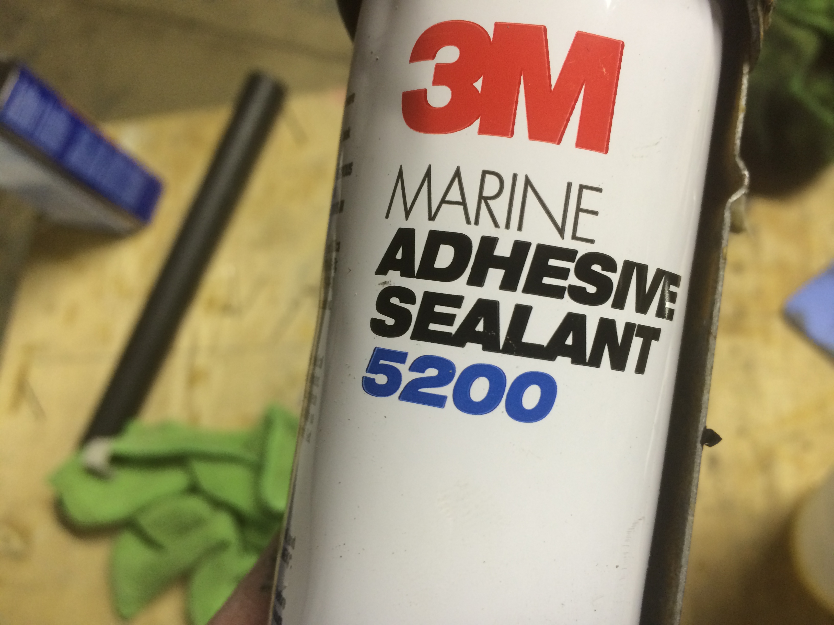

My front bumper top pad is pretty much a loss so thought I would try an idea for a fix that was floating around in my head. I have used this stuff on my boat and thought it had possibilities. It is super sticky adhesive, comes in black, and available at home depot maybe. If not I got this from Grainger.

76-914 Cool. I hope this works and that it ISN'T like... Aug 7 2014, 07:26 PM
gereed75 Another "done" pix. Not sure how it wi... Aug 7 2014, 07:28 PM
saigon71 Looks good! :beer2: Aug 7 2014, 07:39 PM
Porschef 5200 takes a week to cure fully, no problem there.... Aug 7 2014, 08:10 PM
gereed75
5200 takes a week to cure fully, no problem there... Aug 7 2014, 08:24 PM
euro911 Awesome. There's a little chunk out of my rear... Aug 7 2014, 08:25 PM
Krieger That looks great. If you had a mold you could mak... Aug 7 2014, 08:26 PM
