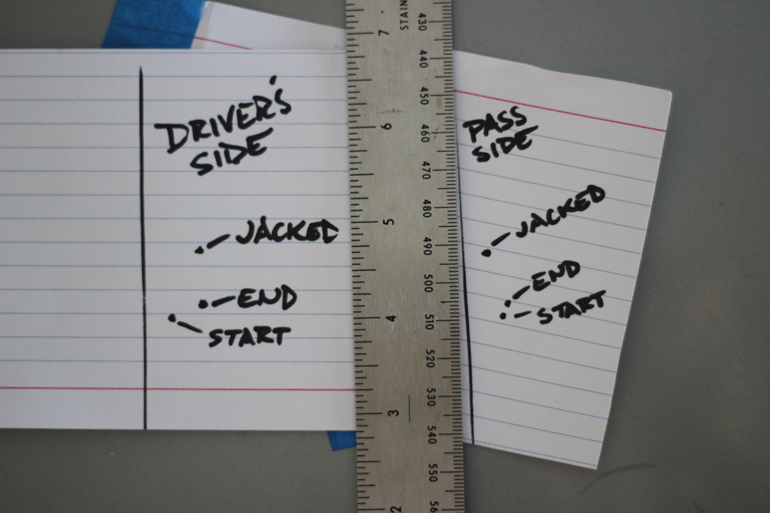

Did a quick and dirty check to see how flexy my frame is. Just stuck a laser pointer on the rear fender with a magnet and aimed it at a notecard taped to the front fender. Marked the position of the dot, then jacked the wheels off the ground and marked the position of the dot again.
Have nothing to compare it to, but will check this in the future after some restoration work. If anyone is game to try this, it would be interesting to compare. |

malcolm2 It's been awhile since I read it, but I think ... Sep 20 2014, 10:24 AM
Cuda911 I like your system! Nice and simple and provid... Sep 20 2014, 10:37 AM
boxsterfan I think that unless you have stripped your 914 dow... Sep 20 2014, 10:45 AM
Elliot Cannon An inner, outer or both long stiffening kit will b... Sep 20 2014, 12:29 PM
mbseto So the first dot is where the laser hits the card ... Sep 20 2014, 08:14 PM
rgalla9146
So the first dot is where the laser hits the card... Sep 20 2014, 08:29 PM
Highland Could the suspension not being fully settled cause... Sep 20 2014, 10:43 PM
mbseto "I'd expect to see the passenger more fle... Sep 21 2014, 10:30 AM![]() ![]() |
