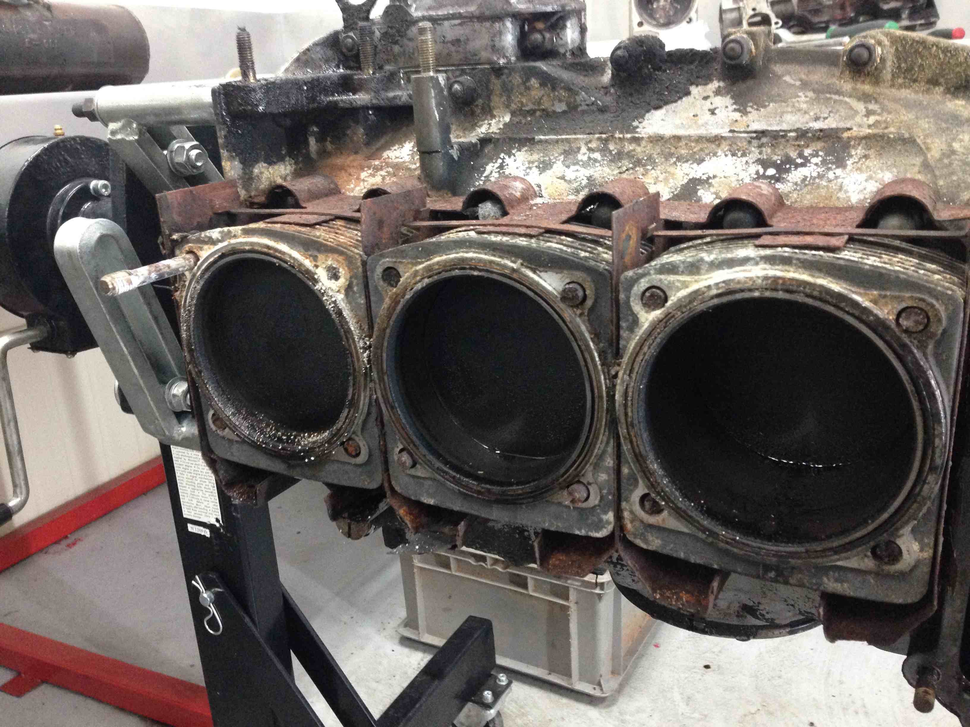

So, I am building a 3 liter for a very low serial # first year 930. The car has been sitting for many years and its been a challenge thus far to deal with.
I knew I was in for a surprise when I stripped the ancillaries off and rolled the engine upside down on the stand and a couple of broken head studs, with their nuts fell onto the ground.. I never dreamed that EVERY head stud except one, on each side of the engine would have been broken! These did not break during disassembly! i only had to put a wrench on one nut on each side of the engine! We've all seen these break like mad, but I've never seen this many broken on one engine. The real crazy thing is, it appears the only reason they stopped driving it was due to chain rail failure that made the bank 2 chain drag loudly inside the chain housing. The heads were sealed tightly to the cylinders and only one of them showed signs of any combustion leakage. The owner wanted something special, so they sent it this way, so I'll see what I can cook up :-) |

Mueller Where was that thing stored?
Do you think this w... Nov 18 2014, 09:59 PM
rick 918-S Wow! You can clearly see the studs are rusted ... Nov 18 2014, 10:11 PM
396 They all broke due to rust on the head nuts an stu... Nov 18 2014, 10:12 PM
Jake Raby
They all broke due to rust on the head nuts an st... Nov 18 2014, 10:41 PM
Mark Henry
They all broke due to rust on the head nuts an st... Nov 19 2014, 08:38 AM
Jake Raby It was stored in a barn since 83.. The engine is a... Nov 18 2014, 10:16 PM
r_towle Wow, the stuff you find with aircooled..
What a pr... Nov 18 2014, 10:23 PM
roblav1 Jake, You are very fortunate that most of the head... Nov 18 2014, 10:44 PM
Jake Raby
Jake, You are very fortunate that most of the hea... Nov 19 2014, 12:39 AM
Jake Raby The car has been sitting since 1983. Though the st... Nov 19 2014, 11:12 PM
Woody Someone along the way upped the boost till it popp... Nov 20 2014, 07:19 AM
Jake Raby
Someone along the way upped the boost till it pop... Nov 20 2014, 07:21 AM
Woody
Someone along the way upped the boost till it po... Nov 20 2014, 07:31 AM
Jake Raby
[quote name='Jake Raby' post='2112659' date='Nov ... Nov 20 2014, 10:26 AM
Woody That's not a bad option and we are considering... Nov 20 2014, 11:17 AM![]() ![]() |
