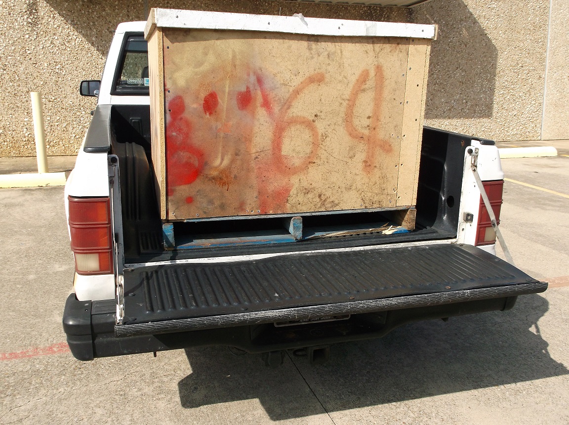

Just arrived from Hawaii...
3.6L 964 motor. Destined to become a 4.0L with 993 RS cams. I am keeping the FI so it is a bit more drivable than the MFI motor I have now.
I actually started this years ago. I bought a 3.6, but it turned out to be unusable. But I had already bought the LN engineering pistons, cylinders, rods and stud kit to make it a 4.0. So now I get to use all that stuff!.
