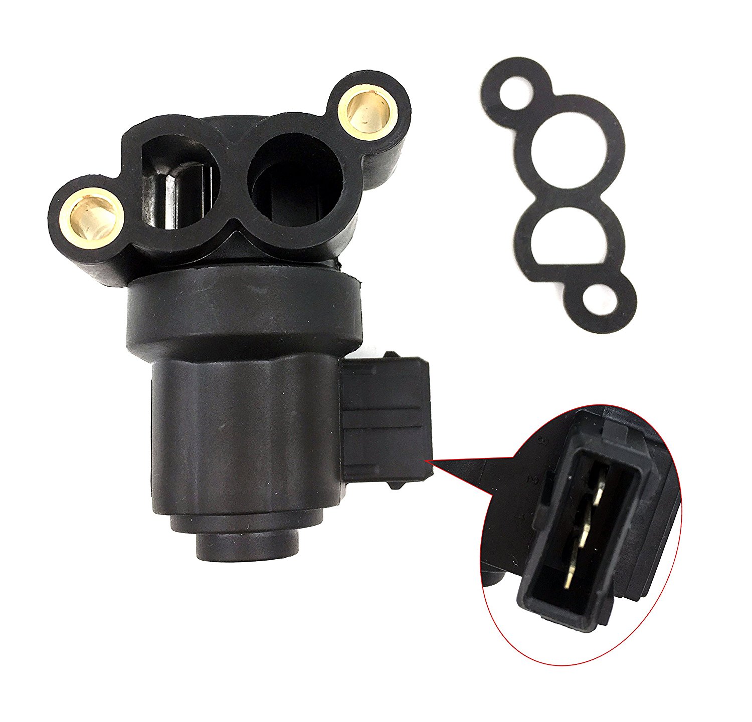

If you follow me on Instagram, you’ve seen that I’m working on a few new parts for my fuel injection setup. This one has particularly broad appeal. It a small idle air valve from a Kia that’s intended to mount onto the manifold. But I modeled up an adapter in Fusion360 to accept hose and clamp. I had this part SLS printed in Nylon from Xometry.com. It was a perfect fit/match and I’m pretty excited to see how this works. Not only is it a valve that can be controlled by mega/microsquirt but conceivably a small circuit could be designed to make this work autonomously for D-Jet and L-Jet cars in place of the AAR.

Vacca Rabite Is there a standard 3 pin wire diagram for this? ... Jul 29 2018, 08:37 PM
McMark Pins are numbered 1-2-3
The center pin (2) is the... Jul 30 2018, 06:28 AM
McMark Official Hyundai valve wiring, specifying Pin 1 as... Aug 11 2018, 04:14 AM![]() ![]() |
