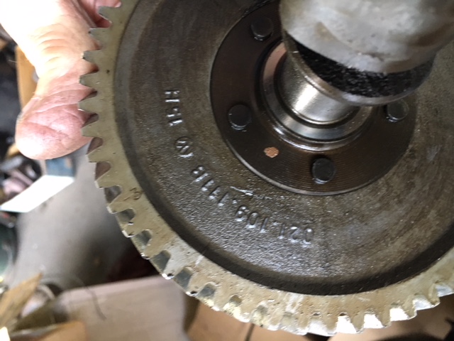

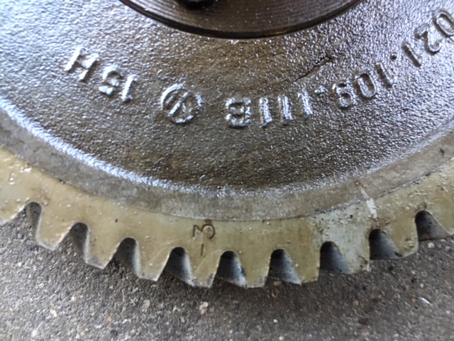

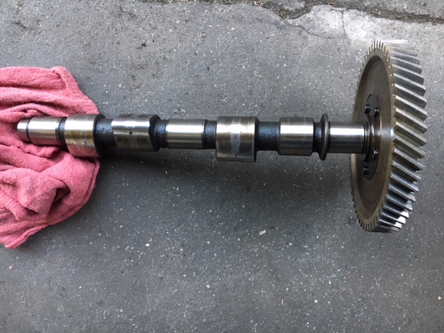

The cam from my '73 is worn and I have secured what I believe to be a NOS replacement part #021109111B that has been separated from its box (will arrive Monday). This is the identical part # to the one that was in my GA case and I purchased it listed as the correct part for my car along with the '76 912e.
However this is merely the part number for the Camshaft gear and there are no additional part #s on the Cam itself.
Questions as follows:
#1: The cam gear is riveted to the shaft as a one piece assembly, so is there anyway that this can be the incorrect replacement shaft?
#2 Cam Gear Part number 021109111C has a corresponding part #021109101K stamped on the cam itself. Some say that the difference is that the C designation is a stronger alloy versus magnesium for the part designation ending in B. Is that correct and would this be the correct cam as well for a GA case? If so, would you go alloy or magnesium? Both gears are marked -3 at the teeth.
#3 Worst case scenario, can the original be reground or would it be foolish to reuse.
#4 Are there any replacement Cams that are as good as or better than the NOS 44 year old OEM option?
Here are some pics as oily engine parts are cool (IMG:style_emoticons/default/sunglasses.gif)
Attached ImageAttached Image

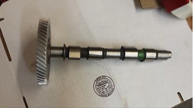

914Sixer   Use the NOS cam you have and forget the rest.   Nov 15 2017, 12:09 PM
Mark Henry   Pretty sure the cam with green paint is a hydrauli...   Nov 16 2017, 12:58 PM
Mark Henry   Just checked, 2 rings, center of cam, 1 each side ...   Nov 16 2017, 01:06 PM

914Sixer   My bad, I did not know that the bands had anything...   Nov 16 2017, 03:30 PM
Mark Henry   One ring, bus FI 75- up, solid lifter, I don't...   Nov 16 2017, 06:06 PM

Mark Henry   021 xxx xxx is a VW bus prefix.   Nov 16 2017, 06:07 PM

Mark Henry   I added the solid lifter to the info. Also is the ...   Nov 16 2017, 06:12 PM

porschetub   Looks like your stock cam re-hardfaced and lifted ...   Nov 16 2017, 06:20 PM
Mark Henry   Cams are marked from +5 to -5, as tooling wore VW ...   Nov 16 2017, 07:03 PM
Dr Evil   From the Porsche PET catalog on line, here are the...   Nov 17 2017, 02:23 PM
914 7T3   From the Porsche PET catalog on line, here are th...   Nov 17 2017, 03:15 PM
Mark Henry   From the Porsche PET catalog on line, here are t...   Nov 17 2017, 04:44 PM
914 7T3   :agree: Thus the name of the thread “Camshaft ...   Nov 17 2017, 05:07 PM
Mark Henry   Oh and the trans case has VW and audi symbols on i...   Nov 17 2017, 05:14 PM
