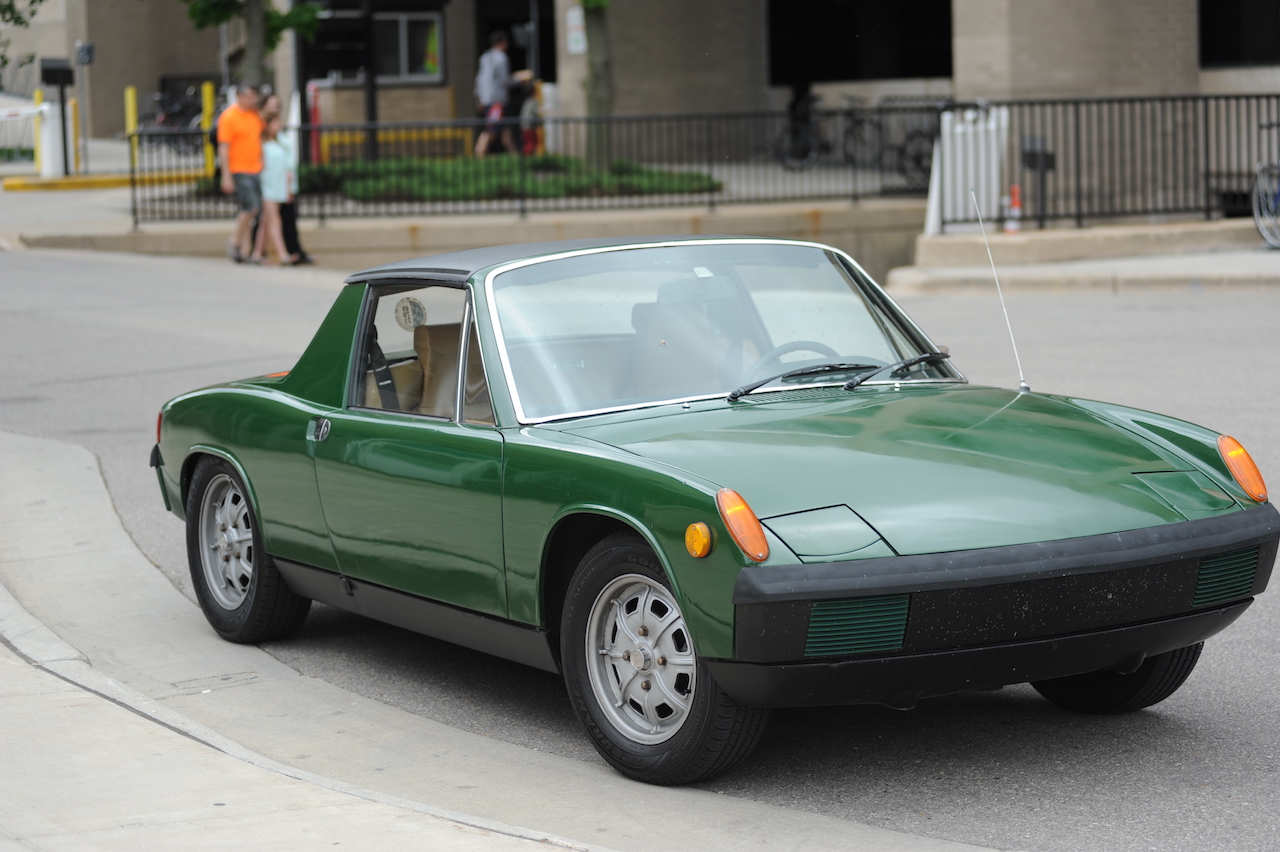

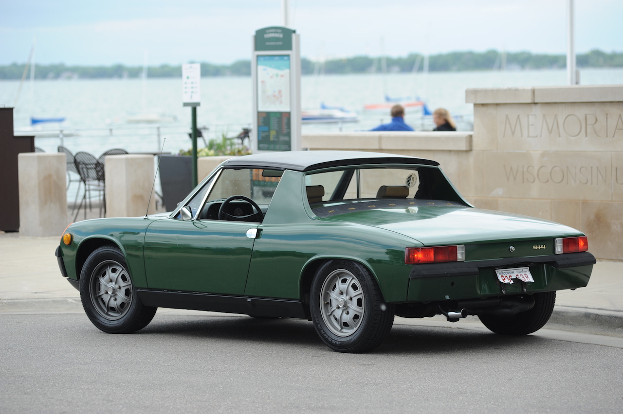

some of you may remember me. After owning for several years a red 1975 1.8L 914, on which I reinstalled the L-Jet, got it to work well, and have sold this summer, I am now working on a 1972 1.7L D-Jet which I got this spring. Photos attached.
