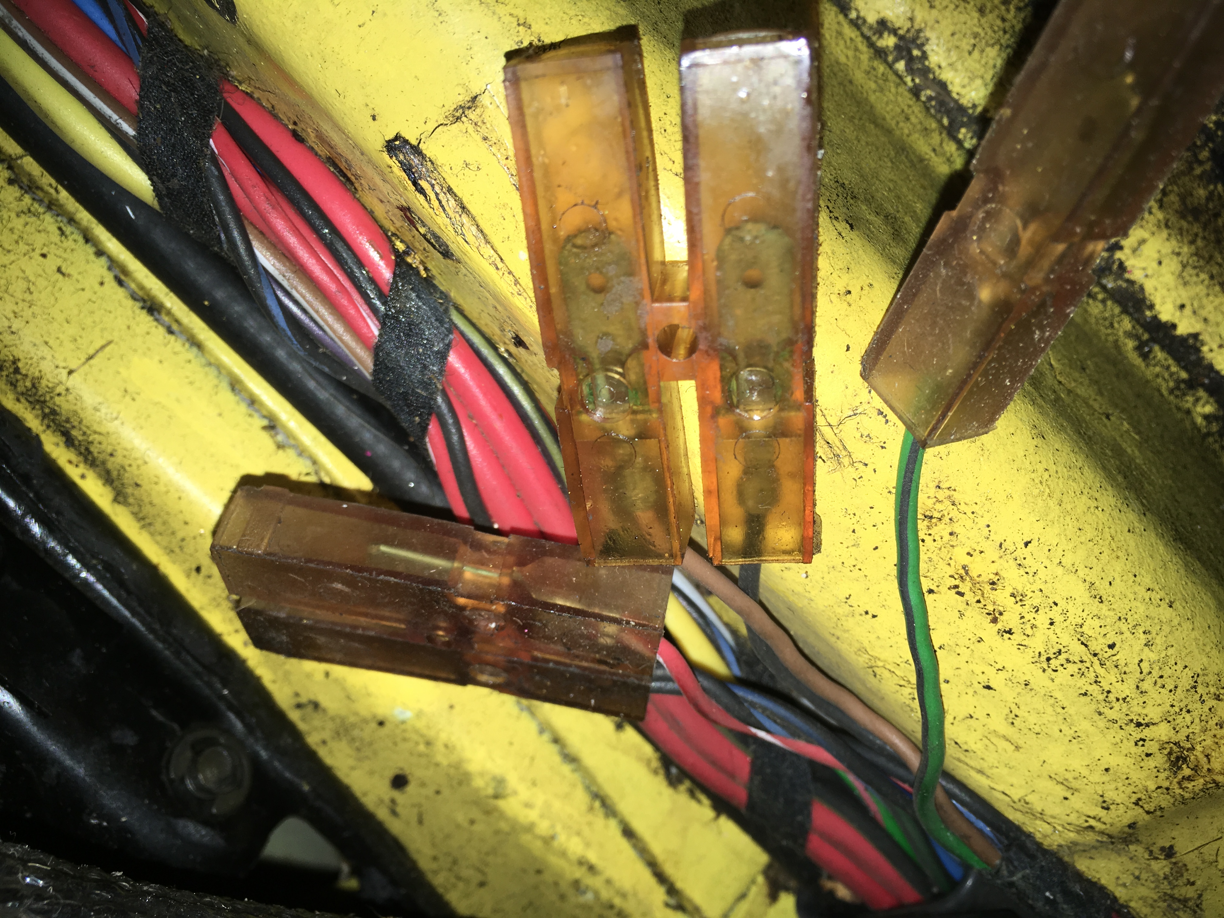

First of all thank you for everybody's patients with all the questions I've been peppering the forum with.
I'm going into do my shift or pushing today and noticed these when I pulled the carpet back. This is obviously factory wiring, and I believe these were in every car but simply unused if you didn't order the appearance package that had the center consul. Is that correct?
Before I dig out a wiring diagram does anyone know offhand what these are for?
Thanks!

bbrock   Those are for the optional center console gauges.   Nov 25 2018, 11:04 AM

Tdskip   Thanks for the confirmation gentlemen. So I can u...   Nov 25 2018, 11:44 AM

DickSteinkamp   OK...that makes sense. I think the only wire you ...   Nov 25 2018, 12:47 PM
Tdskip   OK...that makes sense. I think the only wire you...   Nov 25 2018, 12:55 PM
bbrock   Here's the other end of that sender wire in th...   Nov 25 2018, 01:18 PM
Tdskip   Thanks Brent!   Nov 25 2018, 03:56 PM
JeffBowlsby   P had a specific cable for connecting the dash mou...   Nov 25 2018, 04:19 PM
