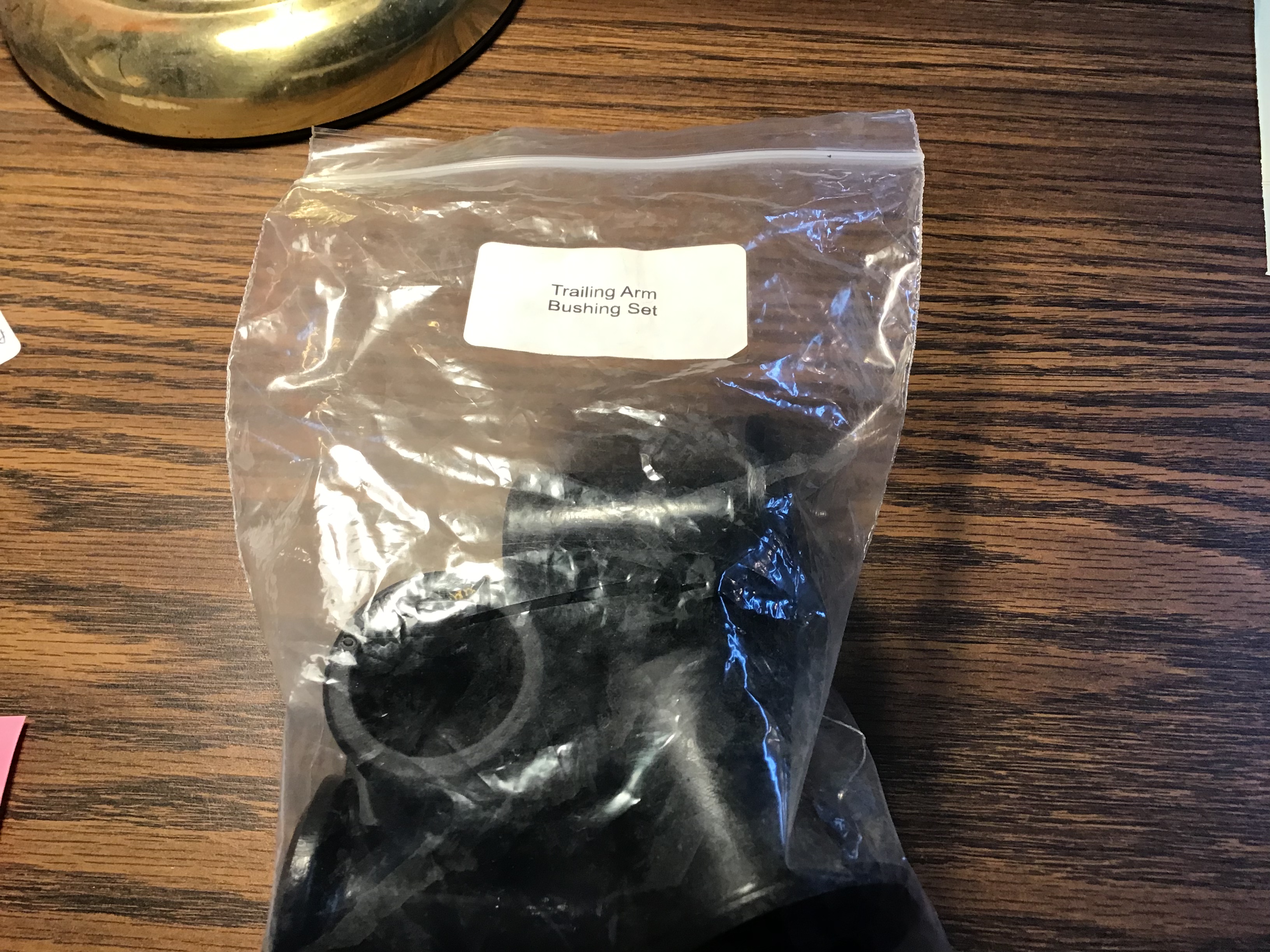

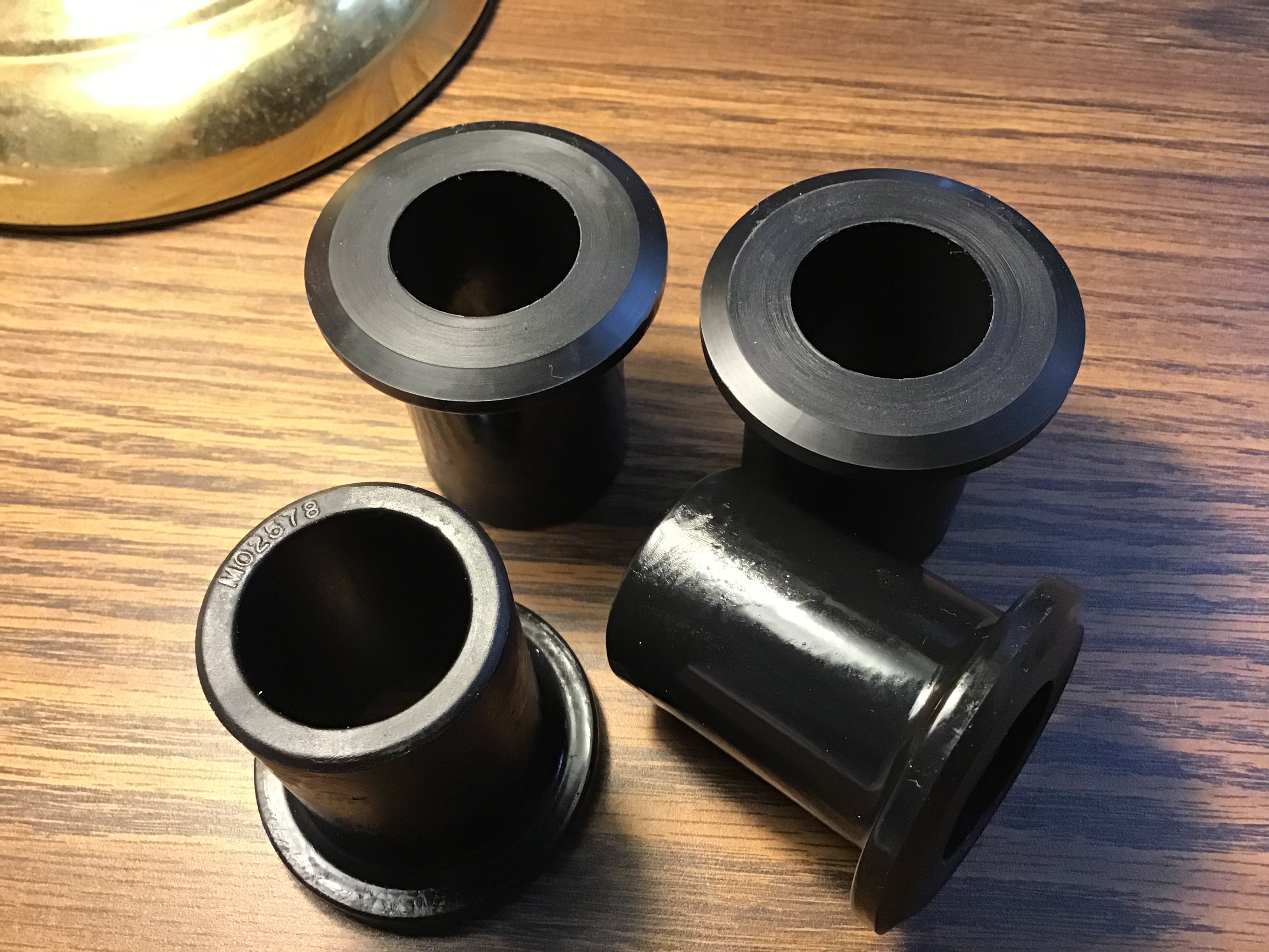

I purchased these along with my a arm bushings. I am about to install the a arm bushings and have a clear understanding of how to install those, but not the trailing arm bushings. I have watched a video on the trailing arm bushings install, but the type of bushing he was using is unknown unless I missed something. Do 914 Rubber trailing arm bushings get installed with grease? Are these rubber or teflon?
Thanks for any input, John |

bbrock Those are harder rubber than the A-arm bushings an... May 13 2019, 08:10 PM
Those are harder rubber than the A-arm bushings a... May 13 2019, 08:37 PM
Morph914 Thank you.
Well, I thought I had everything I nee... May 14 2019, 05:11 PM
bbrock Hey John,
I used electrical tape to wrap around t... May 14 2019, 05:40 PM
Morph914 Thanks, I’ll try boiling for a longer period of ... May 14 2019, 08:07 PM
mepstein Boiling water only gets to 212 no matter how long ... May 14 2019, 08:42 PM
bbrock
Boiling water only gets to 212 no matter how long... May 14 2019, 10:48 PM
bdstone914 @[url=http://www.914world.com/bbs2/index.php?showu... May 15 2019, 08:43 AM
bigkensteele I used a Harbor Freight 12 ton press to install my... May 14 2019, 09:09 PM
