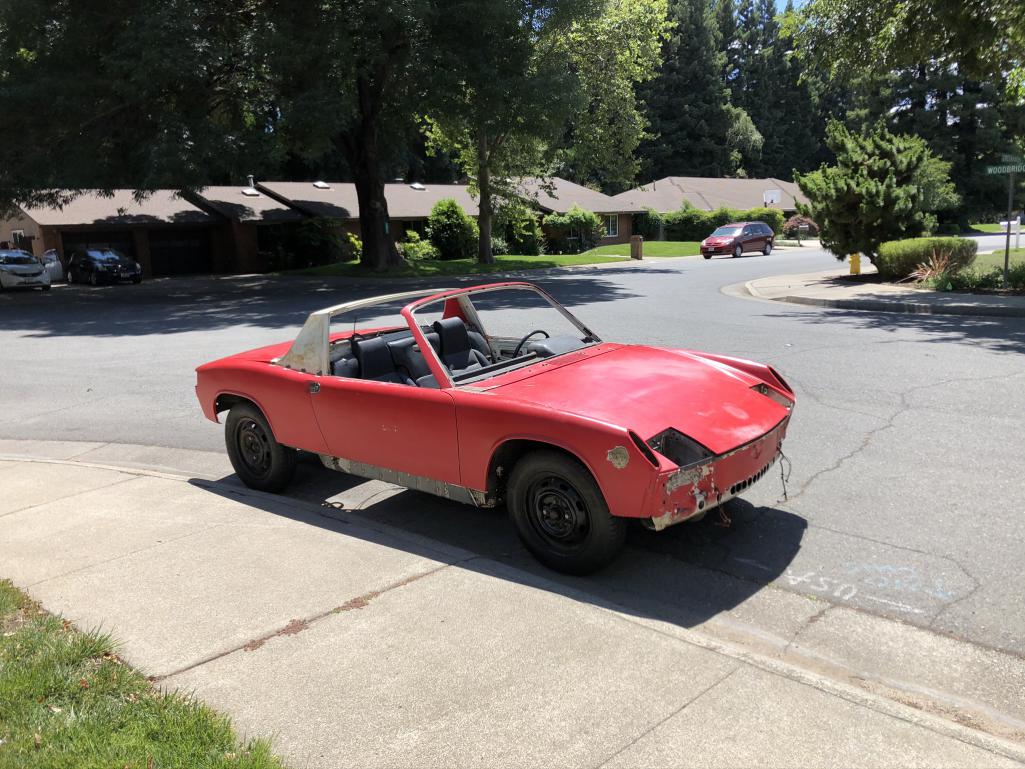

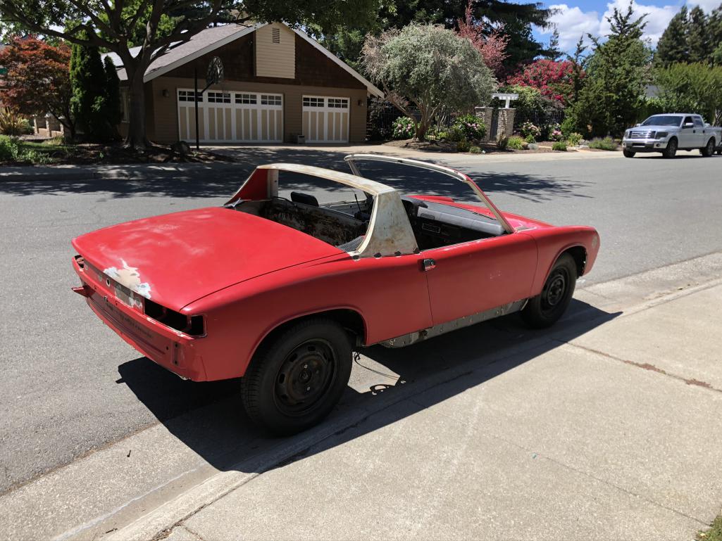

Hi all,
Picked up project car about 2 weeks ago. I'm very excited to get started on this build, I'll try to document and share my progress as I go. I originally created a profile here at 914World back in 2006 when I was in High school, and had bought a 74 914 as my first car for $1200. It was a great first car, I had a lot of fun fixing it up while using it as my daily. When I went off to college, I sold the car, but felt like I had unfinished business to do.
Recently I started lurking here again looking to get back into a project 914 to hopefully take the car where I wanted to, but didn't have the funds, skills, or space to do so.
I posted a WTB ad, and was contacted by a member here who had a good start to a project I plan on finishing (Thanks Montreal914!)
My plan is to build my dream 914 that I absolutely drooled over when I was in High School. I've always loved the GT look, so my plan is to basically create as close to a GT clone as my budget will allow. Steel GT flares, 5-lug Fuch's (or replicas...) and a tastefully somewhat period correct interior. The car I recently purchased did include a freshly rebuilt 2.0 4cyl engine, so I need to make a decision on if I would want to run that engine for a while, and save my pennies to slowly build a 2.2, 2.4 or 2.7 flat 6 then do a swap later down the road.
I'm happy to see the 914 community thriving. Back in 2004 when I first bought the 914, Porsche snobs seemed to turn their nose at them which made them affordable enough for a high-school kid to own one. It seems like the 914 is getting more recognition in the collector community, so I'm happy I picked one up before they become too out of my price range!
I'll post some progress photos tonight and general status of the car tonight after work, but here's a few shots of the day I unloaded it off the trailer.
