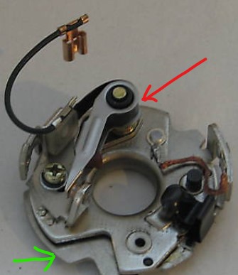

I have been trying to get the dwell angle to the specified number between 44 and 50 degrees. This has been a real effort
I rebuilt the Distributor, I thought I did a good job but the vacuum plate was being touched by the points. The shaft that the spring of the points hinges on has an extension that is used to anchor the points. This extension was touching the plate below the one that the points were mounted on.
The red arrow points to the top of the shaft where the other side there is a protrusion used to anchor the points to the top plate. This protrusion was rubbing against the bottom plate which is shown by the green arrow.
Sooooo, I did what all of us would do and ground the shaft to a few mils, just enough for it to anchor and NOT touch the lower plate.
