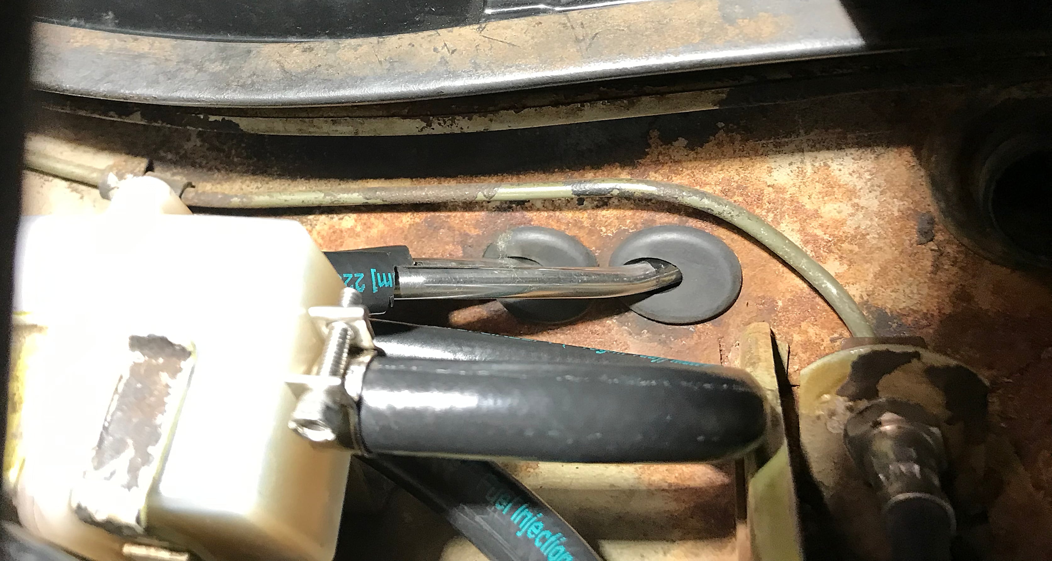

Since discovering my lines routing was reversed in a previous post I am fixing this. I am surely overthinking it. Going from this post:
http://www.914world.com/bbs2/index.php?showtopic=372627 Sort of hybrid of the photos provided, t connector, and slightly bent fuel filter bracket. Return is not connected in yet. Nothing rubs. Seem fine? Double checking before I tighten up as I DO NO WANT to do this again. Much more arduous than expected. |
s13u74cr4 Check my new fuel line routing beneath the shelf please Feb 1 2025, 03:32 PM
Cairo94507 I like the fuel line hose and proper fuel line hos... Feb 1 2025, 03:39 PM
JamesM What I like to do is just have one hose from the f... Feb 1 2025, 03:47 PM
JamesM I also eliminate the pre pump filter entirely and ... Feb 1 2025, 03:52 PM
s13u74cr4 I am curious about this. Have a pic? It's just... Feb 8 2025, 11:40 AM
914werke I have the correct pump connector ... or a update/... Feb 1 2025, 03:59 PM
Montreal914 Found this supplier on Ebay that has a variety of ... Feb 1 2025, 05:35 PM
s13u74cr4 I used this piece from Tangerine to do the the red... Feb 2 2025, 12:57 PM
sechszylinder you should add some kind of heat insulation, like ... Feb 2 2025, 03:22 AM![]() ![]() |
