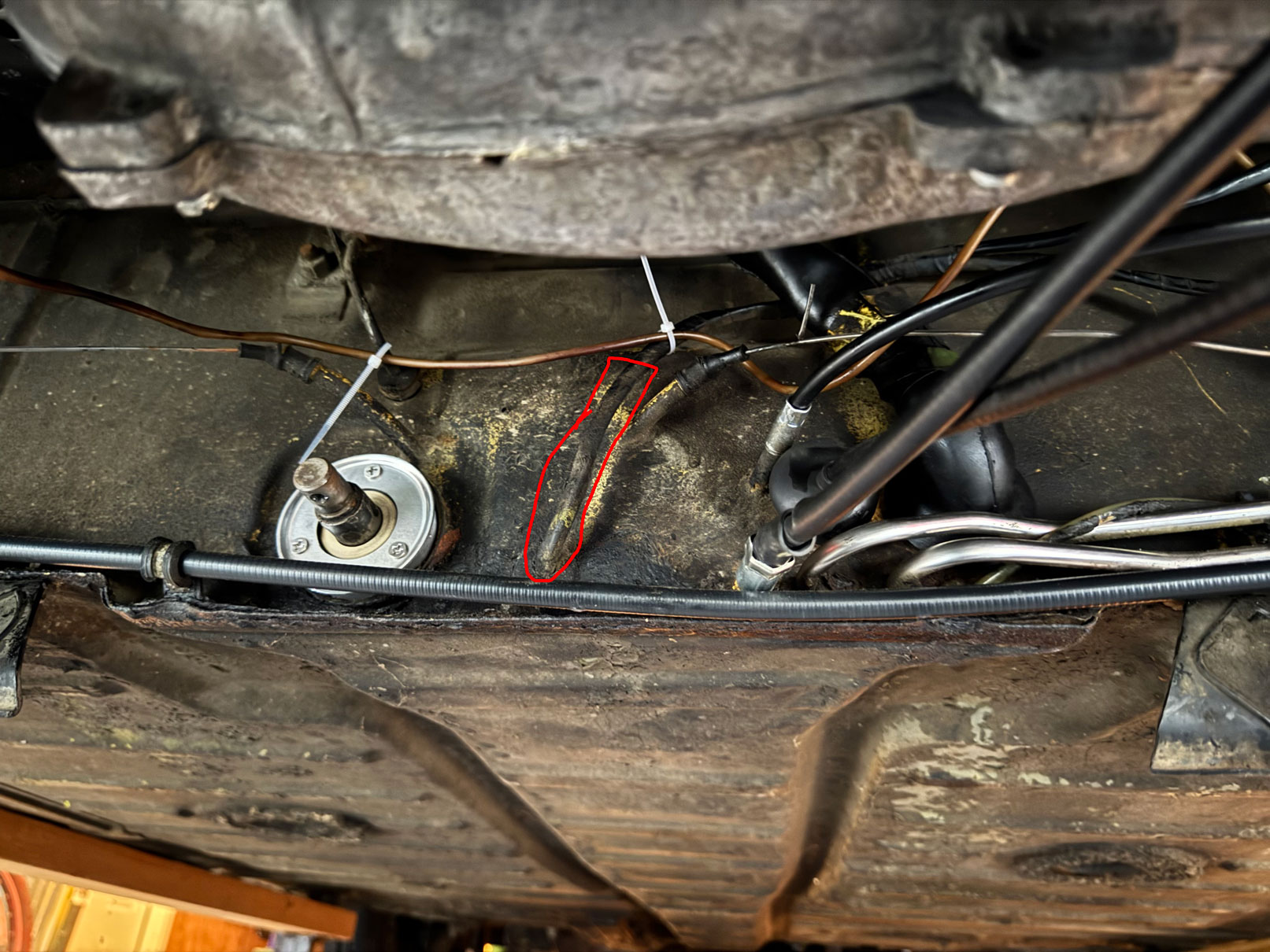

1976 2.0. Putting engine back in after a 2056-dectomy, but it has been out too long and as usual I didn't take enough pictures of all the important connections.
There are many threads on wiring for the starter. However, I have one additional wire that I don't see in any of those threads, but I marked as going to the starter solenoid.
Wire in my hand:
Way off to right:
Out of focus in center:
The wire in question is red and has a spade terminal on the end. It is not the cable that runs from the alternator. My best guess as of today is that is leads up to the firewall and goes through here:
Thoughts? Car has air conditioning, so is this part of that?

Rob-O   Follow it through the engine tin. Where does it g...   Dec 8 2025, 09:54 AM
Blue Lightning   Follow it through the engine tin. Where does it ...   Dec 8 2025, 01:46 PM
Dlee6205   Agreed my car has the "hot start" mod....   Dec 8 2025, 02:05 PM
Blue Lightning   The answer to your question is we don't know....   Dec 8 2025, 03:52 PM

Dlee6205   I just saw where you said your car has AC... its e...   Dec 8 2025, 03:09 PM
emerygt350   That is a beefy wire. The mod grounds to the case...   Dec 8 2025, 06:51 PM
Blue Lightning   That is a beefy wire. The mod grounds to the cas...   Dec 9 2025, 07:45 AM

emerygt350   But doesn't address the problem of the mystery...   Dec 9 2025, 06:00 AM
emerygt350   Hopefully you would use a relay but maybe they wer...   Dec 9 2025, 02:49 PM
emerygt350   Check the resistance on it and maybe send 12v? Ki...   Dec 9 2025, 02:50 PM

emerygt350   Just tried staring at your picture again. I think...   Dec 9 2025, 05:43 PM
Blue Lightning   Just tried staring at your picture again. I thin...   Dec 14 2025, 07:44 PM
