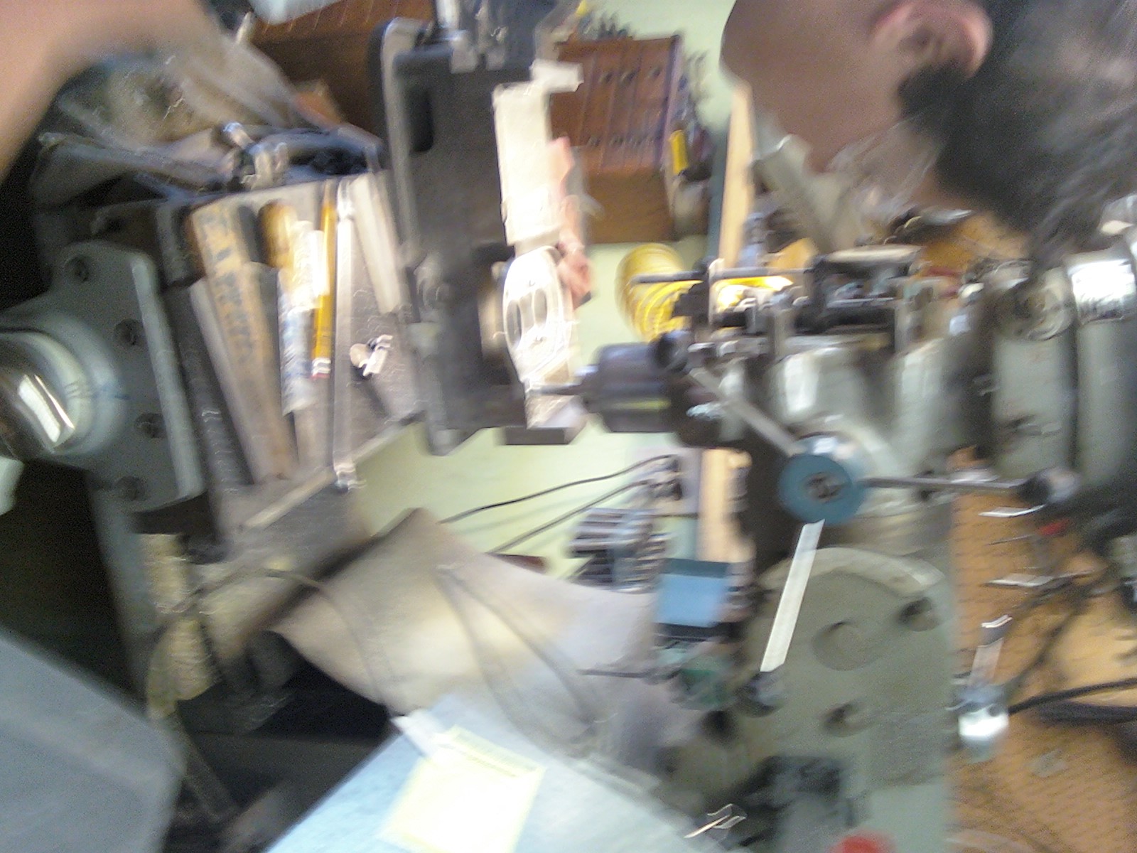

Step 1, Purchase spare set of CB linkage base plates. Proceed to lop off the uprights near flush with the ridge for the air cleaner.
Step 2: Bring beer to a buddy, and he will let you use his mill. Or will even mill things for you (IMG:style_emoticons/default/smile.gif)
Step 3: Order a bunch of parts from mcmaster.com, Heim Joints, Shoulder Bolts, and Springs (IMG:style_emoticons/default/smile.gif)... Followed by - Find out that mcmaster carr will send you homo pinkish red heim joints and laugh at yourself.
Step 4: Drill and Tap Base plates for heim Joints
Step 4: Measure 3x, and cut your new extra long cross bar to length, drill and tap ends to fit the shoulder bolts.
Step 5: Install stainless springs, Stainless Shoulder bolts, and use blue loctite on all threads.
Step 6: Install onto car, note what a great success it is, and drink copious amounts of beer to give yourself a pat on the back.
The setup works great.
It gets rid of the big extension lever on the offset version of the CB plates.... Gets rid of the worn ball and socket pivot, And self centers like the original linkage did.
Hindsight, I would order bearings instead of heim joints next time, and possibly order slightly stiffer springs, or possibly add tension springs on the other side of the heims to increase centering ability.
Enjoy (IMG:style_emoticons/default/smile.gif)
