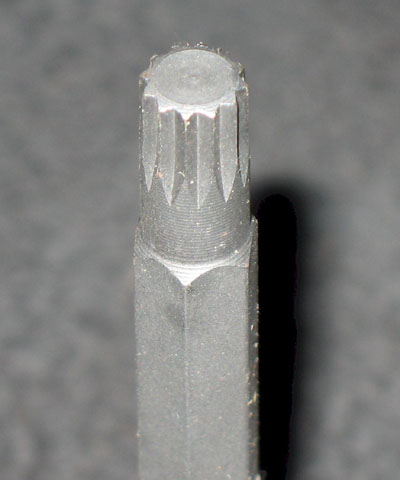

You'll need an 8mm 12-point drive bit to undo the CV joints

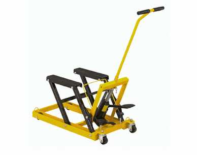

I used a $49 motorcycle jack from H.F this w/e to put my engine in. Worked good (IMG:style_emoticons/default/biggrin.gif)

QUOTE(toon1 @ Feb 19 2008, 08:24 PM) *
The motorcycle jack from harbor freight is the ticket. Place a board across the two lift arms. The trans tail will sit nicely on the back of the lift. Jack the car up and raise the lift to meet the engine...disconect everything and then lower the lift and roll it out from under the car. Personally have pulled 6 motors this way by myself.
It's also nice because you can raise the jack back-up with the motor on it to ease working on it and rolling it around.

BTW, the 12-point tool for the CV joints is a "triple square" (size M8), not just an Allen wrench. A VW Bug shop will have them on hand, as their CVs use the same bolts as ours. So will a Porsche shop, for that matter.

what is the "special " 12 tool used to take the cv joints off. is this a torx, or something i could pickup at a autozone?

12 point with hex shaft for ratchet to remove cv bolts.
check for it at Napa
