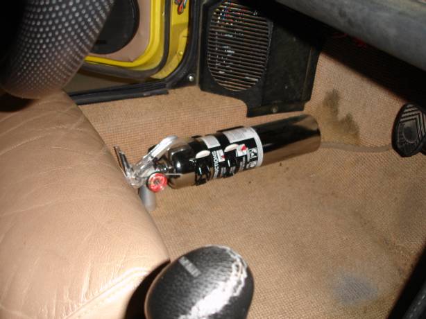

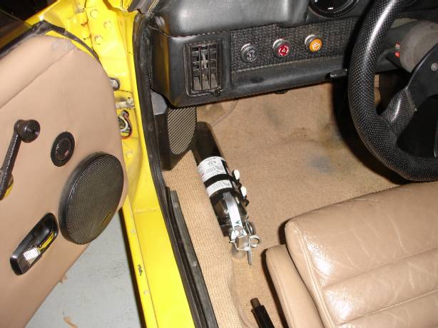

I bought one of the 2.5 lb chrome Halotron ones from Griot's. I swear it was $150 back when I bought it, but they're listed at $200 now. Summit is showing $158 right now for the 2.5 lb chrome one. $120 for red.
I mounted it with the included bracket directly to the driver's side long. It doesn't restrict the seat at all in normal use. I might have to tilt it back to slide it off the rails, but that's all. I occasionally kick it getting in or out, but no big deal. I like having it close.

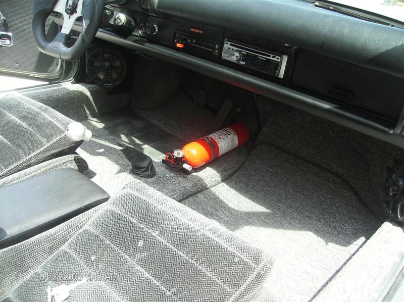

Here's mine. 5 lb. ABC

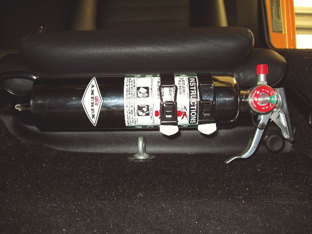

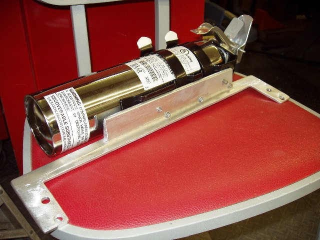

I made a bracket that mounts to the stock seat rails on both sides. Got the idea from the 911 mounts performance products makes. My driver's seat has a broken adjustment handle (still adjusts fine), so this mount may get in the way of a stock handle. Have not had a problem hitting it with a foot either driving, entering or exiting.

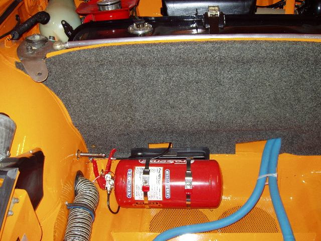

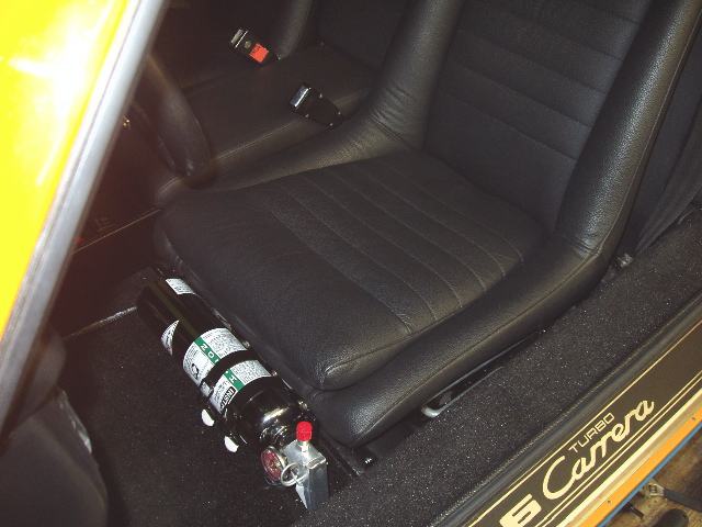

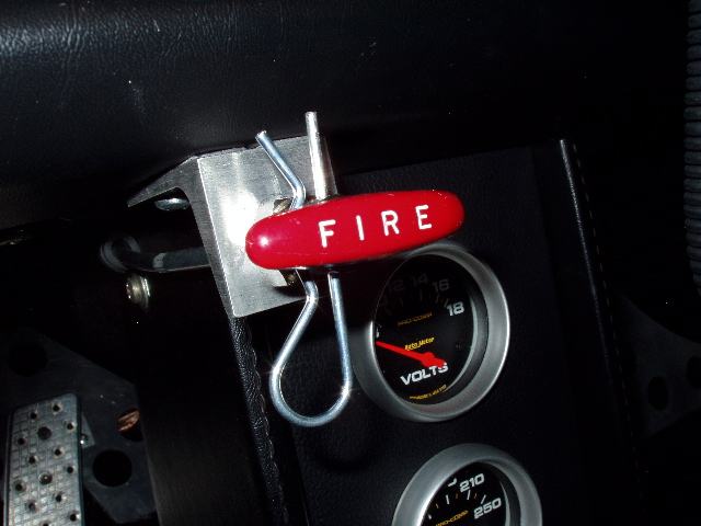

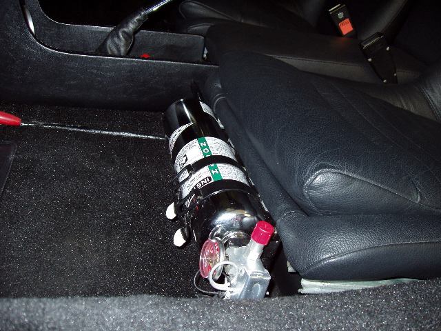

I ended up making my own bracket for the front seat mount and went one step further and installed on onboard fire system.
Attached Image Attached Image Attached Image Attached Image Attached Image Attached Image
