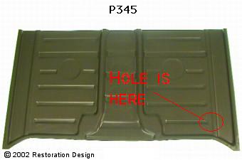

I just got my 914 in today to find much more rust than the car was said to have. Most if very minor and I can repair without a problem. The one spot that has me worried is the section located in the spot in this picture. There is a nice 3" hole there and while looking up in the whole I see some custy rust on the wall between the engine and seats but its not that bad. Other than that it just looks like the rust is in the floor. The battery tray was rusted up bad but to be honest the area under the battery does not look bad at all. I guess this is the Hell hole that everyone is talking about but mine is not near as bad as the others I have seen. Maybe Im missing something but It looks like I can clean up all the rust inside the whole, treat it and then weld a patch on the floor. What do you think?

Grind out any SUSPECTED rusty area with a wire wheel. You will find more, but you will be able to fix it all. Sounds like you probably got a good one.

Have you pulled all the black tar out of the floor pan yet? If so, and that was all you found, you are going to be in great shape. If not, get a heat gun and a scraper, and pull that crap out before planning any rust repair.
For my rear trunk patch, I just got some sheet metal from Home Depot and welded it in. You would be able to do the same with your spot. In the area with the divots, I hit them flat with a hammer, and sealed any potential gaps with seam sealer. In that spot, you will never see the metal under the seat, carpet, and sound deadening. If you already have the welder, this is a $5 fix (your time is free). (IMG:style_emoticons/default/smile.gif)

Engman makes the CSOB kit:
http://engmanparts.com/hellholekit.php
Restoration Design makes some of the parts, but oddly enough, nobody makes a stamped part to repair the hell hole itself, at least as far as I know...
Do like Zach says... get all the tar off the floor to see how bad it really is. Check the lower inner firewall. Check the longs where the floor pan meets them. Pull the rocker panels off and look at the longs and jack points. Pull the vinyl off the sails. Check the cowl at the base of the A pillars. Check the trunk floors.
