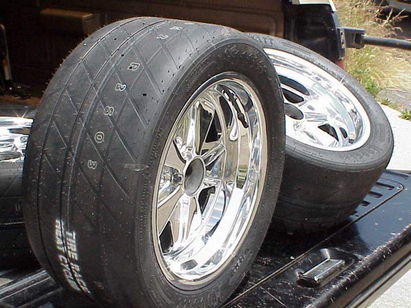

You'll probably have trouble getting the anodizing off with just a powerball. That setup sounds great to maintain the shine though!
To polish, I used a $10 Harbor Freight Air Die Grinder
(IMG:http://www.harborfreight.com/cpi/photos/36500-36599/36572.gif)
and their aluminum polishing kit
(IMG:http://www.harborfreight.com/cpi/photos/94900-94999/94962.gif)
My wheels came out great IMHO
(IMG:http://www.914world.com/bbs2/uploads/post-5027-1176231890_thumb.jpg)

First your rims look great, did you use anything other than the kit from Harbour Station? Or was that just the first step? Mothers Power Ball and polish just recommended for maintaining finish then?

QUOTE(Ian Stott @ May 11 2008, 01:17 PM) *
Ian
I just used the buffing compounds in the Harbor Freight polishing kit (starting with the medium grit (brown) and ending up with the polishing compound (white)). More good info and polishing supplies at Eastwood.
Then I maintain with Metal Gloss.
(IMG:http://sites.browsermanaged.com/folder5077/site_images_system/user/Metal.16.small.JPG)
I found this stuff at a car show at a booth where a guy was polishing a beer keg! Stuff works great. I buy a bottle from the same guy at the same car show every year.
