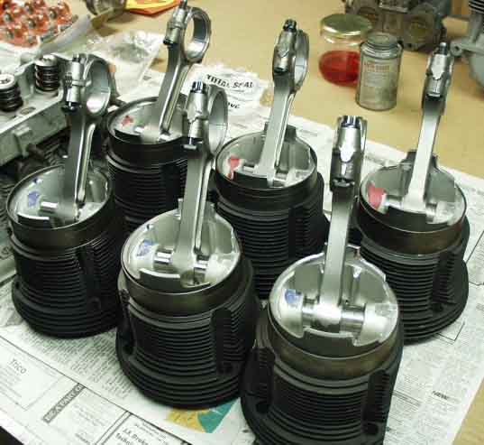

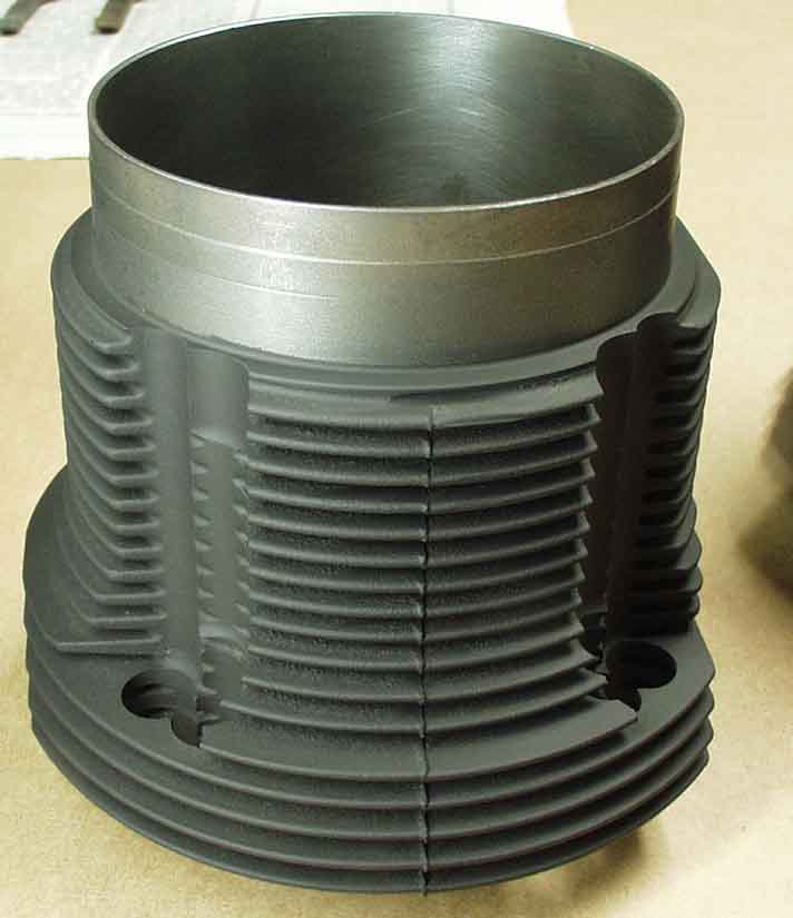

Trim the type 1 cylinder skirt, and drill new holes in the fins for the corvair head stud pattern:

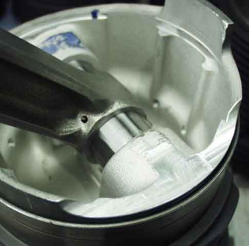

Trim piston skirts to make room for opposing rod end and bolt:
Trim center cylinder side fins down:

Trimming the cyl skirt: you mean making the whole cyl shorter or making the little step you show. Just cutting the lip down is easy on a mill. It doesn't register against anything in the case so its not critical. Making a step will require a lathe if thats what you meant.
Drilling the cyls: The fins will get tricky. Tooling looses rigidity the longer it gets. Since its ony a partial cut the endmill will want to spring away from the cyl the farther down it cuts (and/or chatter.) A LONG carbide endmill might be able to do it w/o flexing away from the cyls too bad. Luckily youre only cutting aluminum and not steel. Or, bore the upper holes (which are important to locate just right), and flip the cyl on its side and use a ball end mill to trim the fins (which can be a little sloppy as you just need to cut off "enough".)
Skirts for rod end bolts: No prob.
Trim center cylinder side fins down: No idea at all what you're talking about here.

The holes in the fins are not needing to be precise, luckily. The pistons are flat topped, and I did intend to clamp directly to the table for milling the cylinder skirts flat.

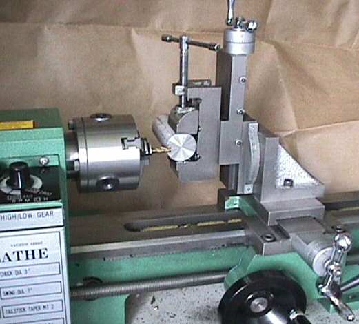

I can convert my mini lathe into a horizontal mill and do the pistons in it and not have to buy a mill, no?

Cutting the cylinders down on a mill would be a cake walk if you don't need high precision. Just clamp it down and hack it off. Trimming the side fins is similarly easy given the low precision necessary. I'd just side mill it, but it would need to be done in two passes; top and bottom. No cutter that I've used is long enough to do that in one shot.

The mini lathe may be used for that piston skirt job, but I don't know how precisely. As I said before, rigid tool setup is everything, and taking an interrupted cut... You'd have to chuck the piston with some brass shim stock (to maintain the finish) and indicate the skirt to make sure it's perpendicular to the spindle axis. Like I said before, +/- .001 is what I'd shoot for on that job, and that includes runnout. I'd also take very minimal depth cuts, as that small tool post will flex a lot under interrupted cuts, and even spring cut once I got down towards the finish dimension.... Oh, I just reread what you said about using the lathe as a mill.... No, I don't think that would work, but you could just chuck the piston up and face the skirts, as I just described.

It'd be hard as hell to drill holes w/ a press. Since the holes are connected to the old ones, a drill is going to try like hell to move over to that hole. Surely you've tried something like that before. Endmills don't have that problem. Maybe you could drill a smaller hole that doesn't break though, and then use a piloted cutter to open it up?
Yes, you actually could use a belt sander even if it is a caveman approach;) Its going to take a while too. How big is your mini-lathe? 7x10? Grab it w/ the inside jaws (pad w/ brass strips) and part off the end. Its just more classy than a belt sander;)
The little mill attachments for a lathe are for REALLY small parts. Though, if you bought a simple iron webbed angle plate (<$20 enco) you might be able to use it as a horiz drill press. Clamp the plate to the cross slide, cylinder to the plate, and put an endmill in the lathe chuck. Though, might be usefull to find the appropriate sized collet to hold the endmill for extra rigidity.
You might even be able to do the pistons that way. You'll have more difficulty setting up the Z dimension w/o fine adjustment, but you could just clamp them to the angle plate at the right height (clamp a fixture block to make repetition easy?). Use the cross for the cutting. Only the cut near the center is critical location wise, all the others are just removing material closer to the edge as you move and clamp the piston further and further up the plate. Make sense?
Heck, you could even do the pistons w/ a die grinder + carbide bur. You're going to need to do something anyway to get them back into balance even if you use a mill.

You guys have what I am thinking about down, I think. Here is a pic. Attached Image
I could fit the pistons in I think.
