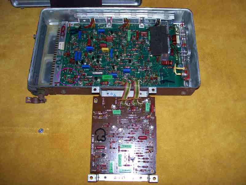

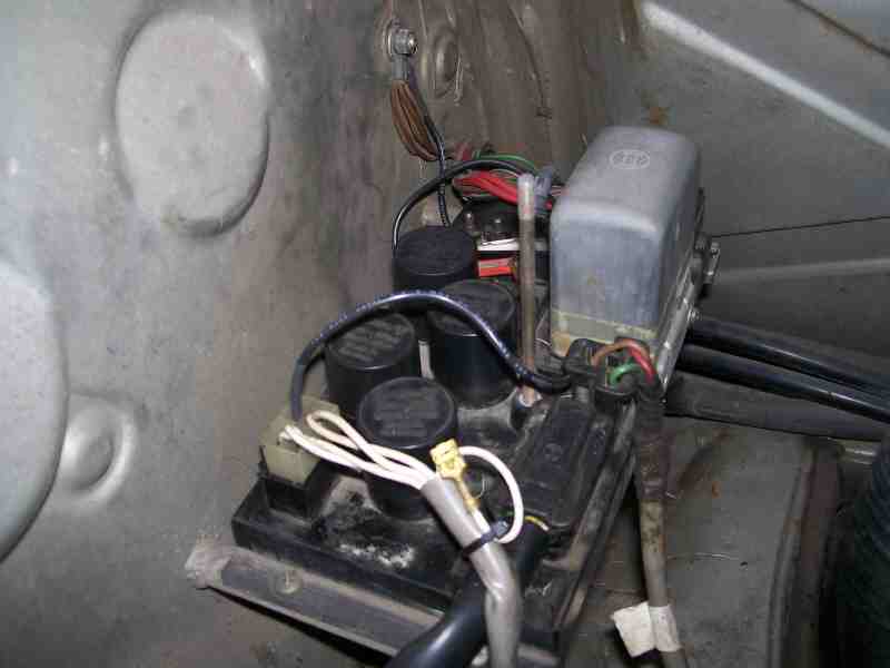

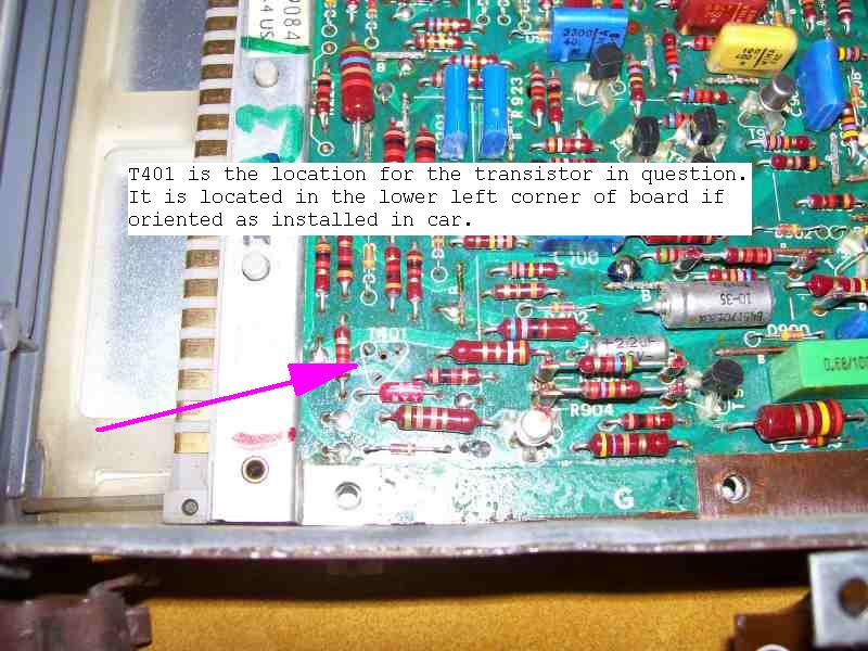

The following pics are of the 015 ecu and relay board in my 1971 1.7. The fuel pump circuit will differ a little on the other version ecu's but i suspect that the culprit will still be the transistor shown here. It may be in a different location the board, but can be located by following the Cable pin trace on the board as i did and looking for obvious problems with the components on the board.

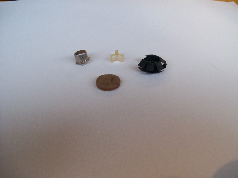

The T401 transistor on the 015 board did not stand up to the "wiggle" test and one of the legs was apparently broken. I began to look more closely at the component and the transistor came of the board leaving the bottom of the "legs" still soldered to the board. This was with almost no force at all. Closer inspection revealed the legs were heavily corroded.
The transistor was mounted with the three legged clear spacer underneath keeping the three pins or legs of the transistor seperated. The round foam insulator(?) was next, with the three pins poking thru it. This is where all the corrosion was and I believe it was caused by this piece of foam. The Electical Engineers here will have to advise what he foam is for. The other piece pictured was epoxied around the transistor body and I believe is a heat sink.

Oh, forgot the transistor pic
and the pic of the relay board modification
