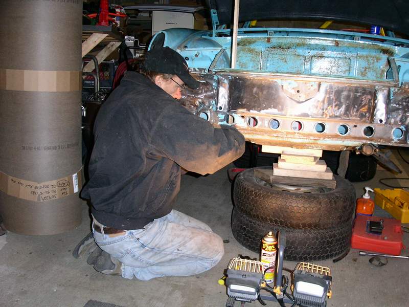

Front susp. is officially removed. So, I guess I will be waiting for a while before it needs doing...
Here's Geoff takin' the A-arms off earlier...

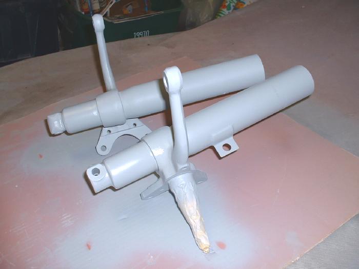

Eric_Shea
post Jan 6 2004, 08:38 AM
PMB Performance
Posts: 19,304
Joined: 3-September 03
From: Salt Lake City, UT
Member No.: 1,110
What about original Koni struts? I don't know them at all.
Bilsteins are easiest. They have a straight tube.
Both of my Koni's (911 and 914-6/GT) are raised 18mm. This is the max. you can raise with a 15" wheel. This is also the max. you can raise a Koni (without performing some of the magic Chris is capable of). Koni's have a similar "buldge" like the Boge's but there's is 18mm to play with. There is no room on the Boge. Here's a picture of my Koni's being primed showing the "buldge" in the tube:
