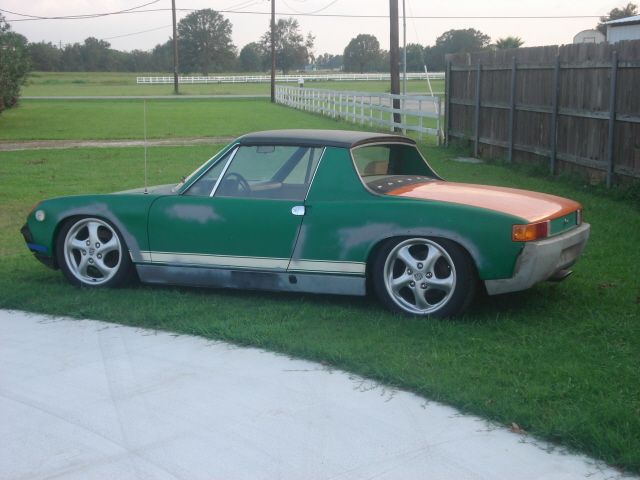

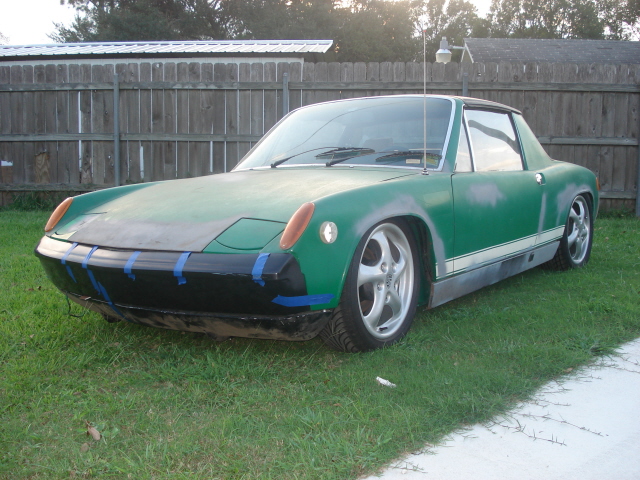

17 X 7 on all four. 1/4" spacers in the back, 3/4" spacers in the front. Fender lips are rolled only as a precaution but would have just barely cleared. Also my drivers side is a tighter fit than the passengers side. 205/50 tires.

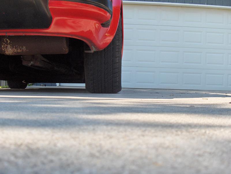

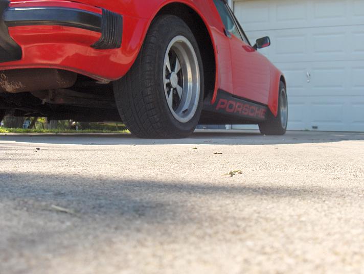

I'm running 15x7" cookie cutters all around with 195/60's in the rear and 195/50's up front. I had to roll the rear fenders a tiny bit, but I have no clearance issues. Here are a couple pics. Thanks

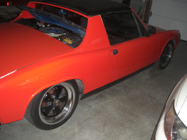

Front 8x16 225/50/ZR 16 Kumhos
Rear 10x16 265/45/ZR 16 "

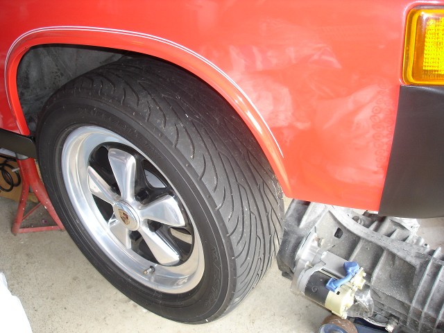

. . . . 6 x 16 with 205s . . . . on jack stands
