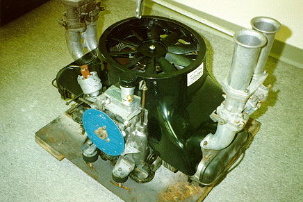

(IMG:http://i71.photobucket.com/albums/i134/Type4Unleashed/REICHERT1.jpg)
Here is a 235 RWHP Turbo Powered Type lV with a Riechert Horizontal fan and the owner say's he is happy with the cooling. And hasn't had belt issues, even when the Turbo spools.

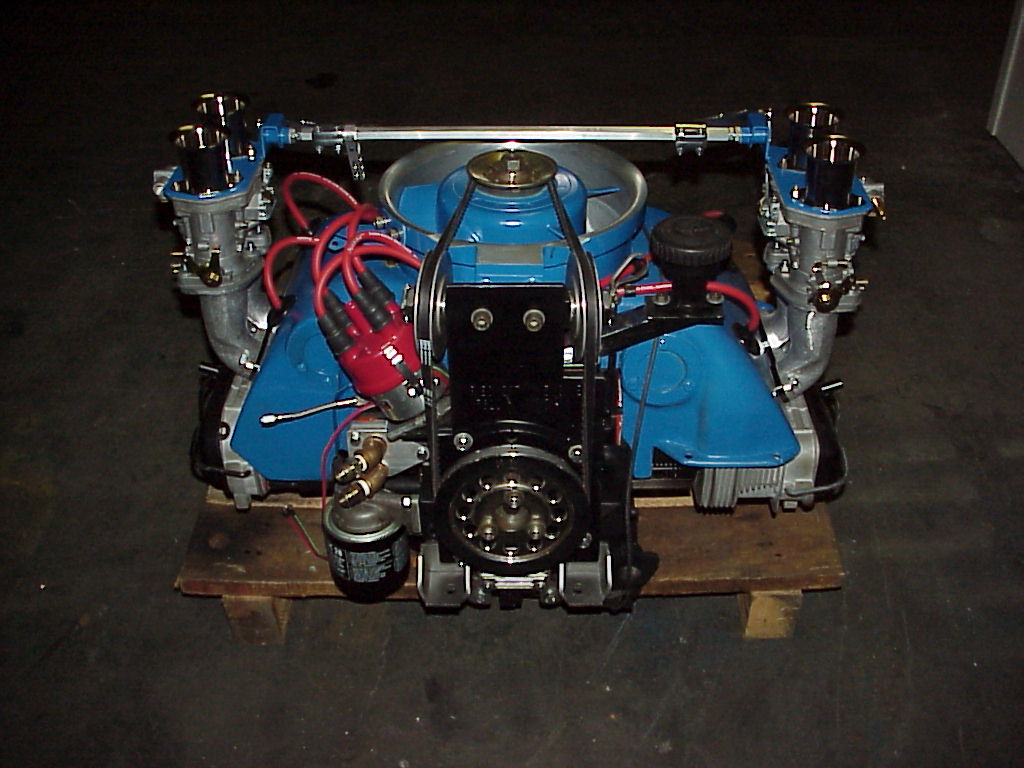

(IMG:http://i71.photobucket.com/albums/i134/Type4Unleashed/68897.jpg)
This is also a Reichert setup, that was made for the military hence the O.D. Green. It was used on a self propelled Type lV powered 70mm Field Howitzer's, used by most of the NATO Armies.

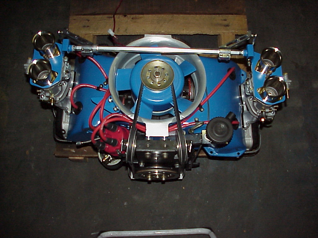

(IMG:http://i71.photobucket.com/albums/i134/Type4Unleashed/Flat01.jpg)
This one is made by http://www.laperformance.co.uk/ and they are still available
