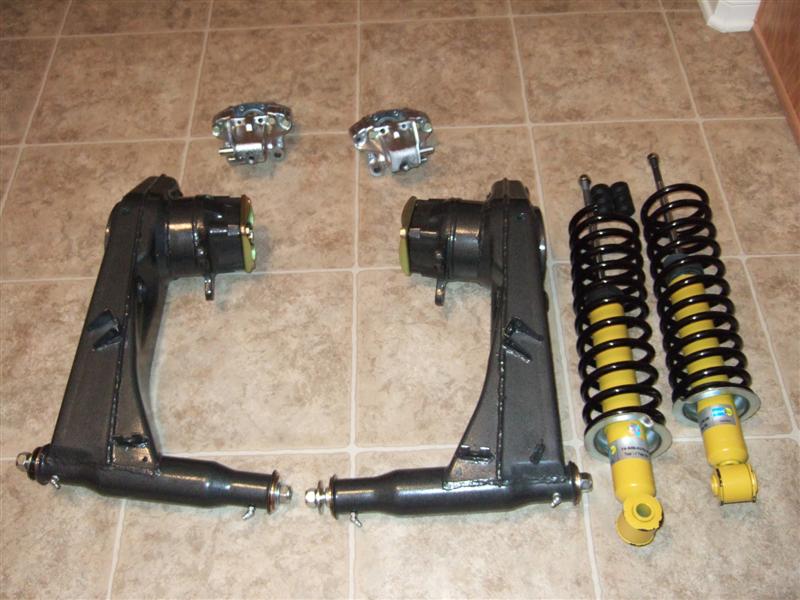

Lou,
I think your outside zerks are on 180 degrees off on the tube. They'll probably interfere with the outer control arm mounts. (IMG:style_emoticons/default/sad.gif)

QUOTE(Eric_Shea @ Nov 9 2008, 04:10 PM) *
Lou,
I agree... I just did this and it looks like your outer one will be buried inside the mount when installed while your inner will be pointing up into the body when the suspension is free hanging and impossible to service. I suppose you could drop them to service them each time... I wouldn't but it could be done.

QUOTE(Eric_Shea @ Nov 9 2008, 06:10 PM) *
Lou,
Yup, Eric and Rob you're both right, I fixed them before I installed them. (IMG:style_emoticons/default/smile.gif)

QUOTE(Lou W @ Nov 9 2008, 05:22 PM) *
Lou,
I would have done the same thing but our Car Of The Month boy Paul Sayegh warned me to mock install them and mark them... Otherwise I would have picked the same spot, in fact I had Sharpie marker in the same spots (IMG:style_emoticons/default/biggrin.gif)

QUOTE(ConeDodger @ Nov 9 2008, 07:28 PM) *
Lou,
I didn't think the instructions were very clear, then I had a tough time trying to find someone who had a replacement zirc fitting, mine broke off when I mounted one of them. Elephant Racing guys were very helpful in rushing me out a replacement.
