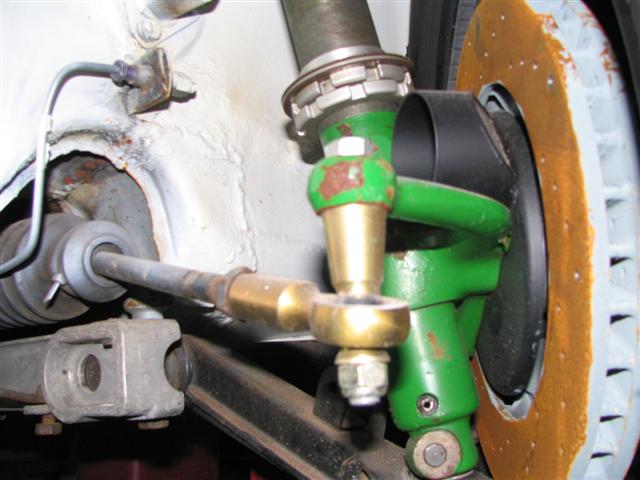

ERP tie rod extensions are the way I went. Bending is the steering arm is iffy.
It must be done right. A guy with a hammer & torch is gonna have broblems making both sides the same.

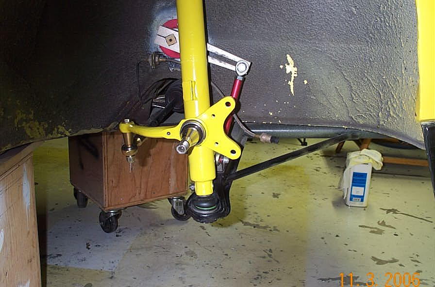

Actually, if you're talking about bump steer, it's more important to get the tie rods parallel to the a-arms.
With the car on the ground, your a-arms should be close to parallel to the ground, but bump steer is really when the a-arms and tie rods are not in the same plane ...

I have taken the time to measure how much suspension compression ....at the strut...is taking place up front. I made decisions based on that and how far I could lower the car....keeping off the bump stops is gud, IMO.
Raising the spindles gave me another 3/4 inch of shock travel and allows me to lower the car that much more.
How ya'll deal with bump steer is your problem. I showed you my method.
Show me your method to do it better on your car and I'll listen.
Yes, I have rack spacers also.
I've been running the extensions for 2-3 seasons on an AX venue that is rougher than a cob.....using 9.5 inch Hoosier slicks. Don't plan to go off road, tho.
There's "believe" & then there's experience.
So this is the key? I have my car up and I will assemble the front suspension without the torsion bars, but with rack spacers and turbo tie rods, elephant bushings. I will jack up the front a arm until it is level or slightly down and see what that tie rod looks like in relation to the a arm. I will also look at it throughout the range of motion. I will post some pictures and see what I've got. Maybe this weekend. Still no ideas on bending that knuckle down?
