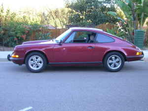

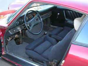

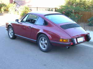

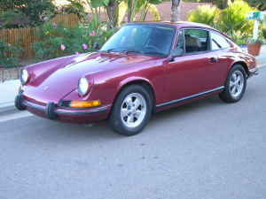

1969 Porsche 912 - $6800 - $6800
Reply to: see below
Date: 2009-02-19, 10:05AM PST
1969 Porsche 912, runs and drives great.
Paint has a great shine, not rusty like most old Porsche's.
Has a 5 speed that shifts smoothly, Recaro seats and 15" Fuchs wheels.
$6800,

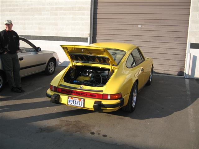

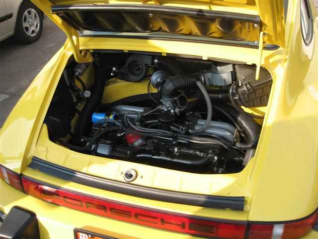

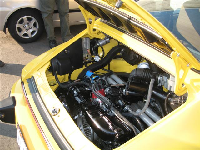

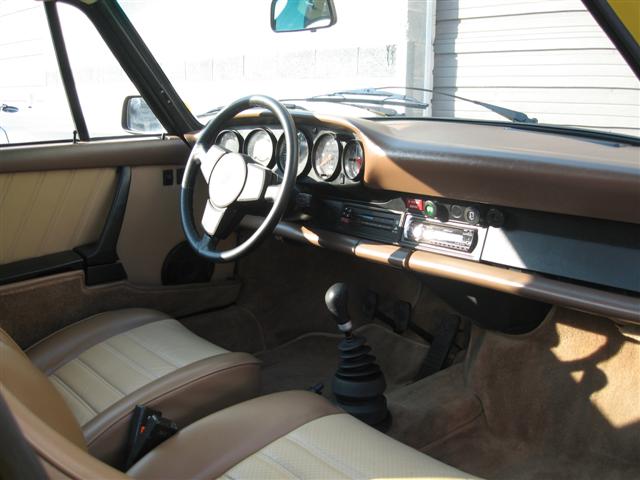

Heres a 76 912 with a raby type 4 in it.

Only the 76 912 came with the type 4. Probably the preferred model if you can find one. They seem to be going up in value.

In 1976, Porsche produced a 912E that used the 2.0 L type IV motor with L-jet fuel injection. The '67-69 912 used the 1.6L carburetted motor that was used in the 356. If you decide to buy a 1976 912E, realize that the exhaust system (heat exchangers expecially) are specific to that model and only about 2100 912E's were produced. This means that a factory replacement of the heat exchangers could be very expensive and the same holds true for some other one-model specific parts (ie, flexible rubber intake tube between throttle body and AFM).
