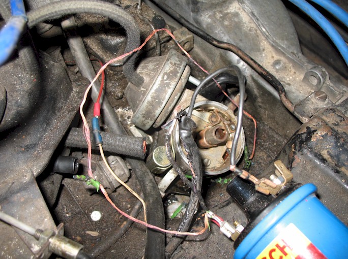

why did my wire from my coil to my points/condensor fry - up in smoke : (

messix   the rear relay board harness plugged in one set on...   Jul 6 2009, 04:47 PM
Project 6   Something grounded out. You're gonna need a F...   Jul 6 2009, 05:03 PM
jt914-6   The condensor wire should be connected to the nega...   Jul 6 2009, 05:17 PM
914Sixer   In George's Tech Tip book page 84, 621: Never...   Jul 7 2009, 12:38 PM
Cap'n Krusty   In Georges Tech Tip book page 84, 621: Never lea...   Jul 7 2009, 02:39 PM
jimkelly   dang : ( appreciate the explanation though : ) j...   Jul 7 2009, 01:33 PM
jimkelly   i could have sworn that i did not move this wire f...   Jul 7 2009, 03:16 PM
Spoke   i just ordered some crimps and a good crimp tool ...   Jul 7 2009, 03:57 PM
jt914-6   The condenser wire and the tach wire (blackW/purpl...   Jul 7 2009, 04:05 PM
