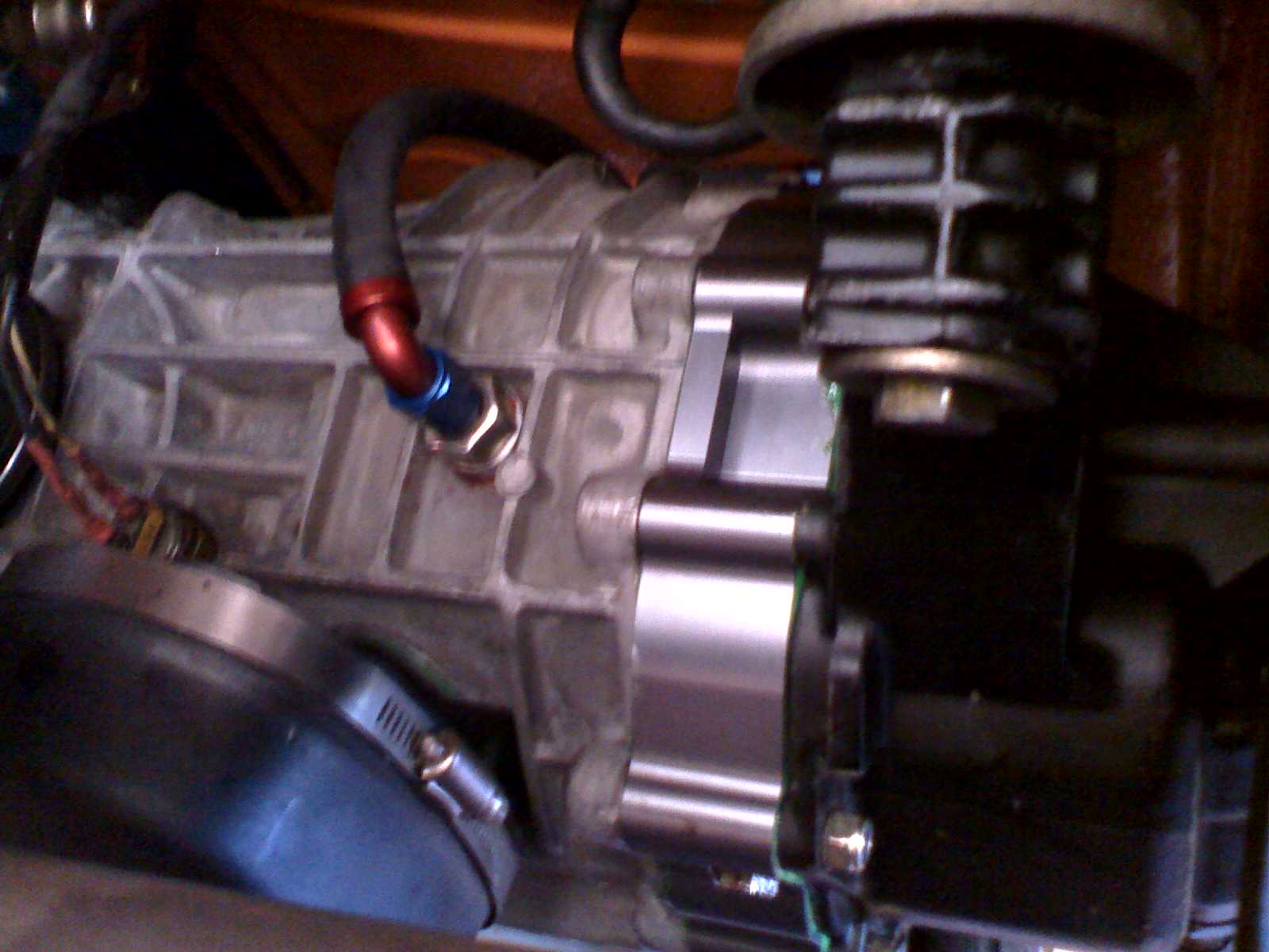

Did I read correctly that one could use the fill and drain plugs tapped for cooler lines for in and out?
This sounds like a step in the right direction, as i could install everything, and then install the internal spray bar later when I have the tranny out.

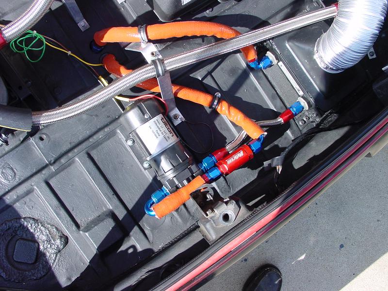

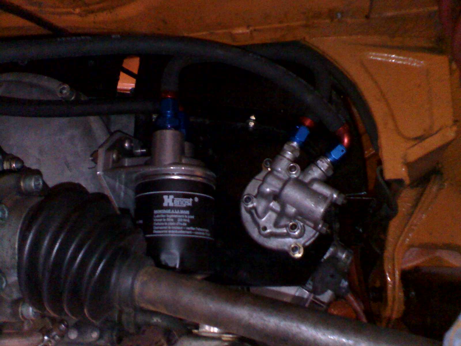

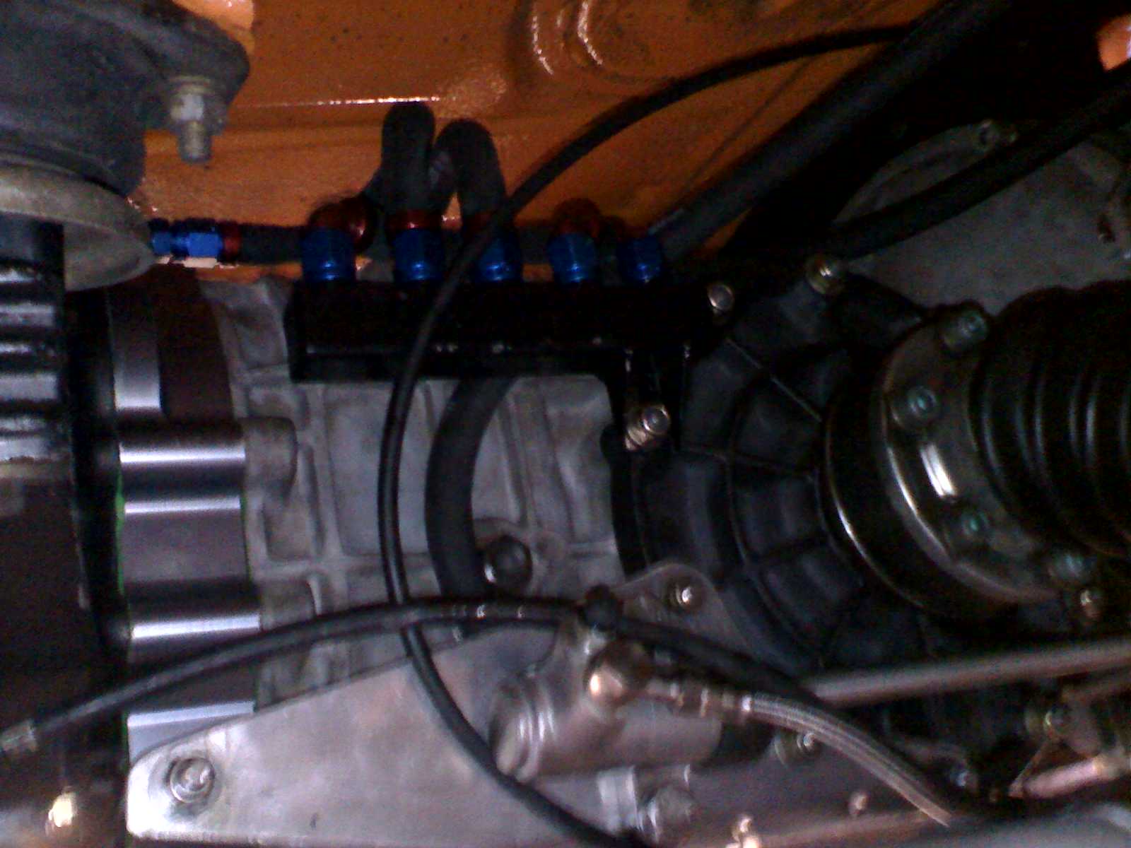

Cooler mounting position:
I mounted my 2nd engine oil cooler (off of the sandwich adapter in the picture) behind the transmission. I initially mounted a fan but never had to turn it on, so I removed it. For this trans cooler addition, I'm considering a "cooler-sandwich" in the same position with both engine and trans coolers and a spacer in between them. The downside is that if I back into gravel I could get cooler damage and the day would be done, although I did it once at Texas Motorspeedway with no damage... I'm still embarrassed about that one...
A fan might be needed then... don't know yet until I can record some temps. I like ambient cooling if it's enough, since the power requirements are restricted to the pump(s).
John suggested mounting it high, like on the floor of the trunk with air ducted into it. That would be easier for certain, both for access and drainage. I'd lose some trunk space but perhaps not so much!

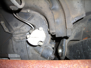

Downunderman
post Jul 10 2009, 03:21 PM
Post #31
Posts: 852
Joined: 31-May 03
From: Sydney, Australia
Member No.: 766
Region Association: Australia and New Zealand

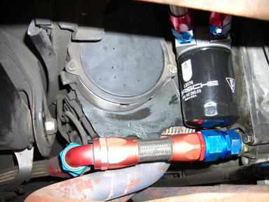

Here are some photos for posterity. Before it had the cooler installed.
pcar916
post Jul 11 2009, 08:02 AM
Post #32
Is that a Lola?
Posts: 1,524
Joined: 2-June 05
From: Little Rock, AR
Member No.: 4,188
You realize your car is far too clean right? Nice simple installation.

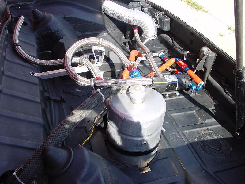

Here are a couple of picts of the setup I had and what a lot of the vintage racers run.
pcar916
post Jul 15 2009, 10:21 PM
Post #35
Is that a Lola?
Posts: 1,524
Joined: 2-June 05
Member No.: 4,188
Simple... fan underneath or scoop only?
john rogers
post Jul 16 2009, 12:55 AM
Post #36
Posts: 1,525
Joined: 4-March 03
From: Chula Vista CA
Member No.: 391
An axial boat ventilation fan was added after these pictures were taken in the vent supply line. It comes on when the lube pump starts. There is a baffle under the cooler outlet to provide low pressure when the car is moving and the air is supplied from an inlet in the front of the right rear GT flare.
