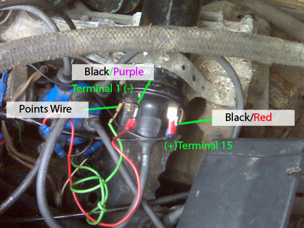

Post a close up pic of the coil wiring.
Rich

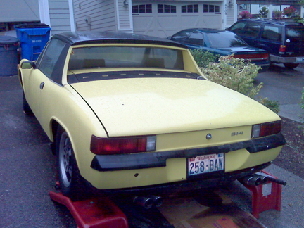

Here are some pics of the car... (IMG:style_emoticons/default/biggrin.gif)

QUOTE(r_towle @ Aug 11 2009, 08:26 PM) *
Rich
I will do that in the morning... the ignition harness was just cut out of the car from the previous owner without a care thinking he was going to convert it to carbs. (IMG:style_emoticons/default/headbang.gif) I had to add length to it so that they would reach.

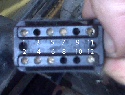

well it appears I don't have pin 8 or 9 on the ignition harness...does this look correct?

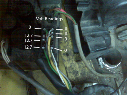

Here are the volt readings with the ignition on. Both fuses on the relay board show 12.7
The ign. harness was cut. I had to add length... the wires shown are not the correct color so I labled the photos. Please let me know if this looks right.
I am not getting spark from the coil.
Thanks...
