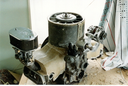

So I want to get a fresh block and rebuild a 2270 street engine. I have always loved the look of horizontal fans and would really like to integrate this into the build.
I have seen a few, (even an electric one) but which would be recommended? Would it be worth looking into building a 90 degree coupling? (or would it be too power sapping) - I have access to lots of billet and machinery, so If anyone has done such a thing I would be very interested to see what you have done.
Anybody running a HF in a Fourteener? Would love to see pics if so.
Thanks in advance.

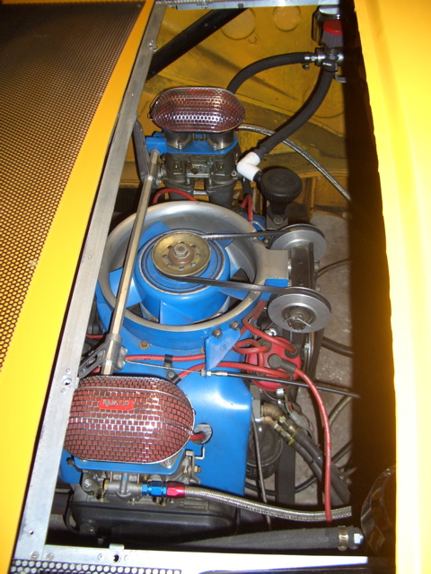

Chris uses a modifed Corvair horizontal fan.
Search on the internet for the Corvair fan setup.
Check the two or three German tuners that specialize in type4 motors. (look at tunacans type 4 secrets links page) and you should find a setup that is still being sold.
If you want to make it yourself, look for a 90 degree industrial gearbox...McMaster Carr and MSC have them.

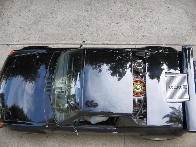

http://forums.pelicanparts.com/showthread....97138&pp=20
http://www.914world.com/bbs2/index.php?sho...amp;hl=riechert
http://www.tangerineracing.com/Engine.htm
(scroll to bottom of page)
Another pix of a Reichert setup:
URY914

Again, talk to Chris Foley...he seems to have figured out the trick to keeping belts.
Porsche used the horizontal fans on most of the big motors in the race cars...might be something to that.
